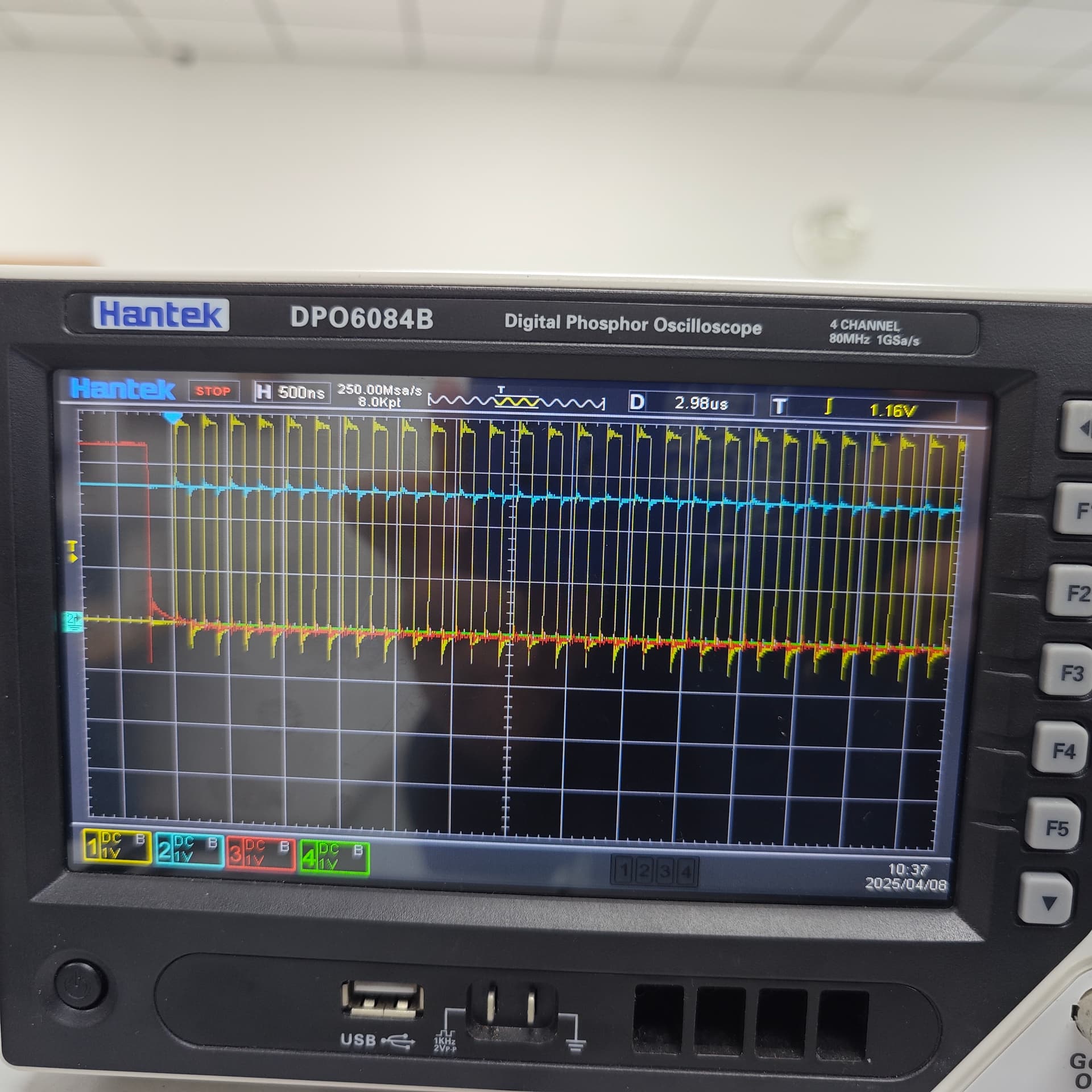

But when I checked the SPI signals with an oscilloscope:
The oscilloscope shows an ​abnormal SCK signal (blue). Could you help confirm whether this is caused by:
  1. Hardware damage (e.g., broken SPI controller or circuit), or
  2. System/driver issues (e.g., misconfiguration or incomplete debugging)?
Have you confirmed that you measure the correct line for SCK?
If it does not work as expected, how could you get expected data line(MOSI)?
Have you configured the pinmux before use?
Could you share the block diagram of your connection between SPI master and slave?
