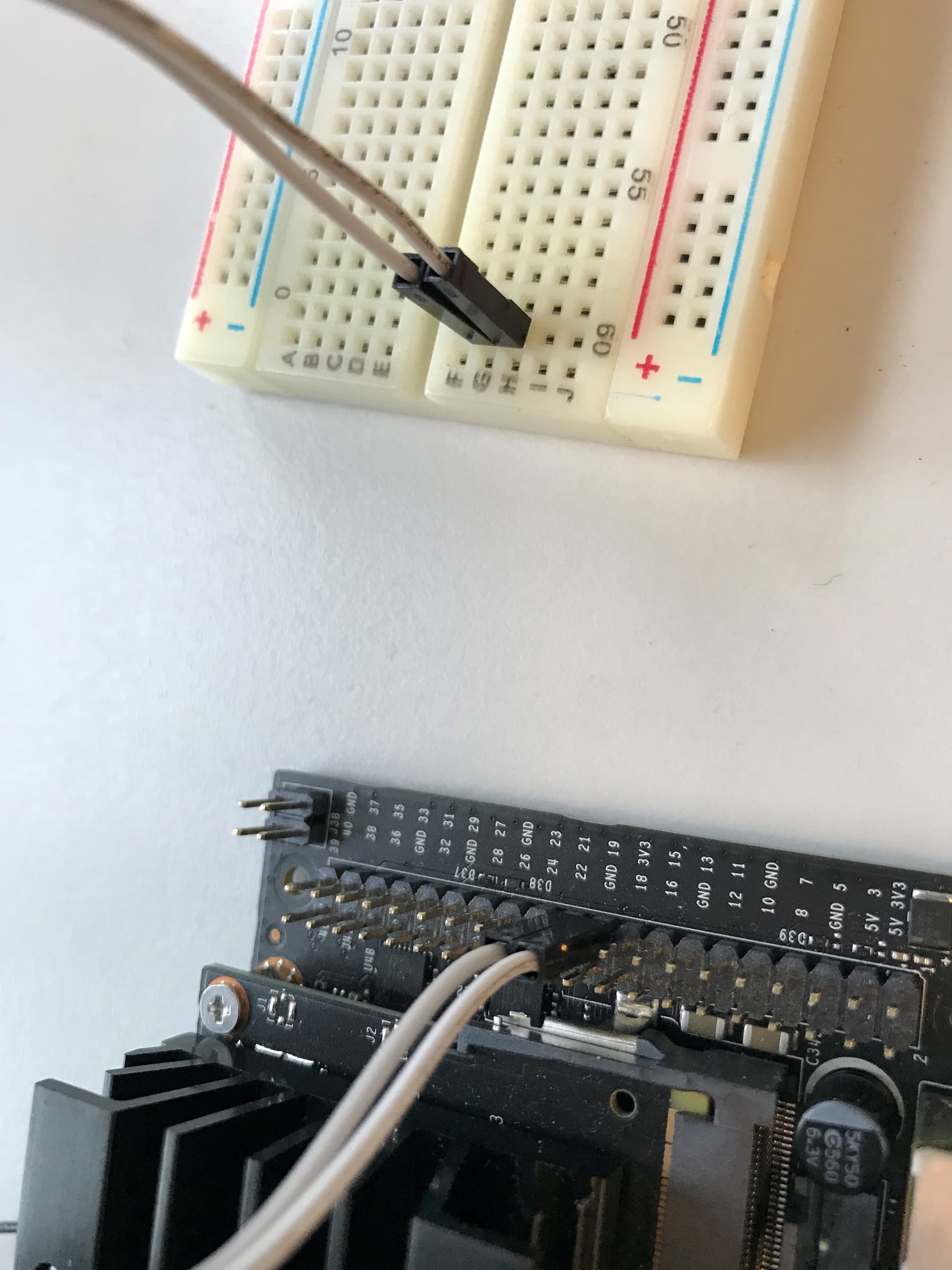

I have a problem with configuring SPI on the Jetson Nano development board. Hopefully, anyone here can help me out with solving this problem. I have tried the following:
First I executed the following commands:

I plugged the Jetson’s pin 19 (also tried the other pins 19-26), but the osciloscoop showed a flat line (plain 5v and 3.3v is visable)

Please update to J4.6 or latest and use jetson-io to configure the SPI and short the pin19/21 to run the loopback test by spidev_test to confirm it.

The pin status is correct. Could you check the loopback test by spidev_test?
Hey @ShaneCCC, I really appreciate your fast response. I tried running the spidev_test and it gave me the same error. I could hook it up to an oscilloscope if that would be more conveniënt?
Screenshot_4
This is the wiring
The pin19/21 should be the spidev0.0 instead of spidev2.0

It states ‘command not found’ when I try an example command
blindsight@blindsight:~/spi_test/spidev-lib$ spidev_test -D/dev/spidev0.0 -s18000000 -n100 -g30 -p4
bash: spidev_test: command not found
Run below command in the folder that you download the attached file instead of …/spidev-lib/
sudo ./spidev_test -D /dev/spidev0.0 -g16 -zz
Hey @ShaneCCC again thanks for your reply. I tried executing the command and it still couldn’t execute it.
blindsight@blindsight:~/Downloads$ ls
smartgit  smartgit-linux-21_1_3.tar.gz  spidev_test  spidev_test.txt
blindsight@blindsight:~/Downloads$ sudo mv spidev_test.txt spidev_test
[sudo] password for blindsight:
blindsight@blindsight:~/Downloads$ sudo chmod +x spidev_test
blindsight@blindsight:~/Downloads$ sudo ./spidev_test -D /dev/spidev0.0 -g16 -zz
using device: /dev/spidev0.0
can't open device: No such file or directory
Aborted
Did you load spidev driver first.
sudo modprobe spidev
@ShaneCCC that was the solution. The test passed now. Do you have the source code for me for that spidev_test file? The .txt is already compiled. This way I can implement this solution now I know that SPI0 could work
blindsight@blindsight:~/Downloads$ sudo ./spidev_test -D /dev/spidev0.0 -g16 -zzusing device: /dev/spidev0.0
setting spi mode for read,write
setting spi bpw
setting max speed for rd/wr
spi mode: 0
bits per word: 8 bytes per word: 1
max speed: 10000000 Hz (10000 KHz)
no. runs: 1
Using seed:0x61a0d887
loop count = 0
using sequential pattern ....
transfer bytes [16]
0000: 00 01 02 03 04 05 06 07 08 09 0A 0B 0C 0D 0E 0F
transfer: Return actual transfer length: 16
receive bytes [16]
/dev/spidev0.0: TEST PASSED
