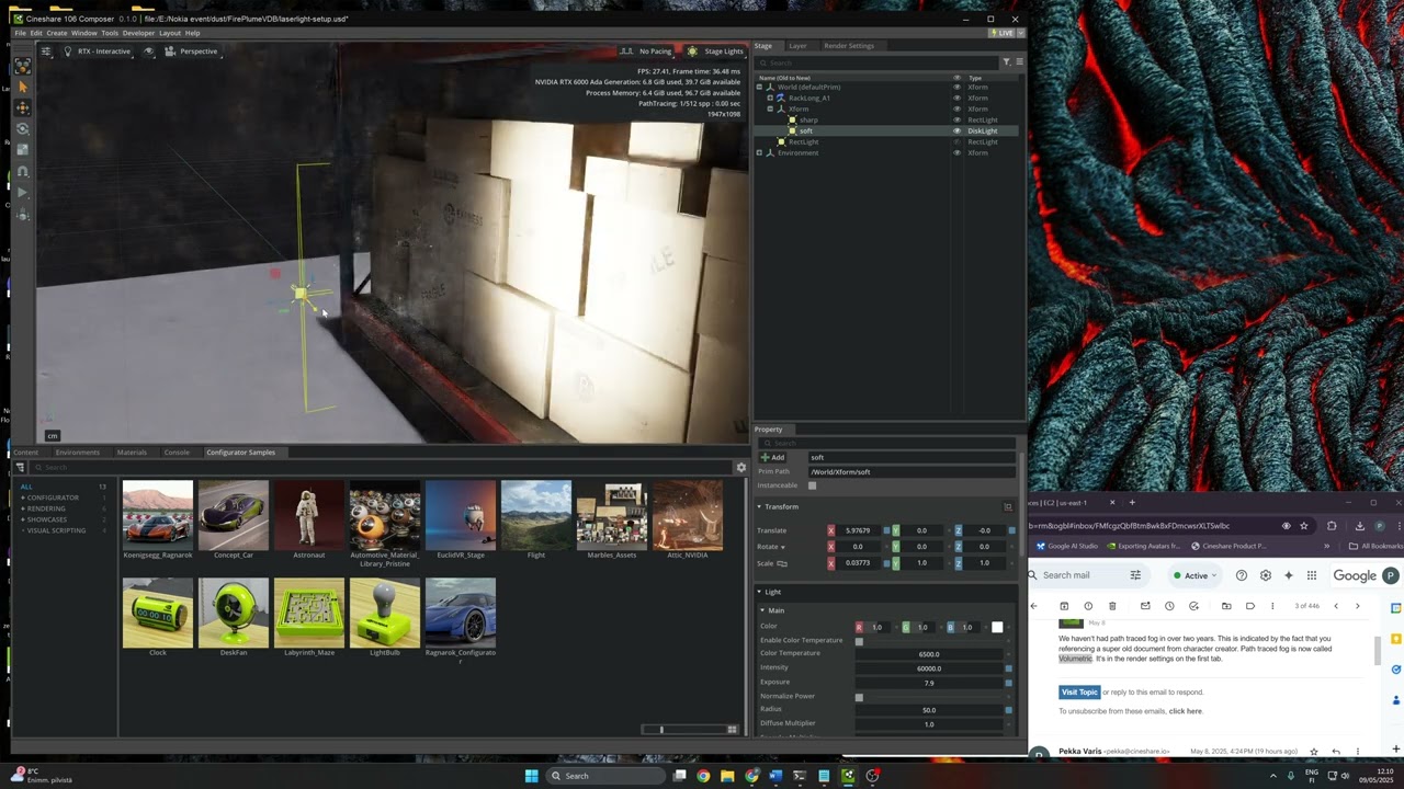

All right, now I got it why I did not “found” the god rays settings.
Since I try to create a laser scanning light, it reacts to air and dust a little different way.
See I make a super focused rect light and while focusing so hard, it looses the “volumetric fog effect”:
As you can see the cheap and dirty solution would be to extract the light from hitting the boxes.
But I found a more elegant way.
I solved this by using a still vdb frame that have a smoke/fog/dust MUCH on the other side.
I positioned this so I get that narrow laser on disco floor smoke effect :D
Now I do not have to make separate render passes for this, Heureka!
Check that out:
I made some test renders, loos like the second render is good enough here:
VDB tends to get blurry on low sample / motion blus settings.
