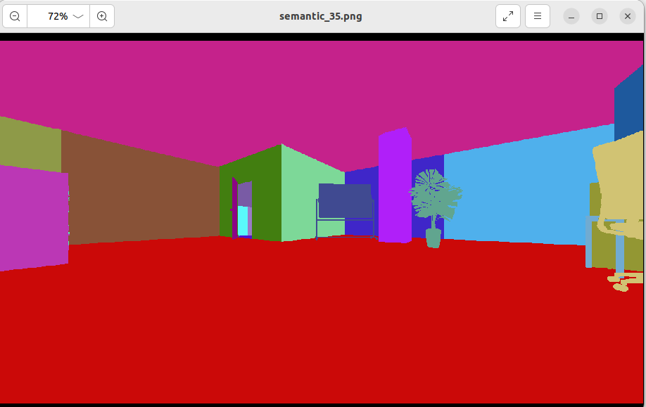

I’m collecting data to train a robot, specifically storing semantic, RGB, and depth images from three cameras. However, there’s an issue with the semantic data: the colors for the semantic segmentation change each time I save the images, even though I’ve set the semantic data in the editor. What I want is for the semantic colors of each object to remain consistent.
The solutions I’m considering are:
- Saving the segmentation information in advance as a YAML file, then reading it during runtime to assign segmentation information to each object based on that file.
- Capturing the Instance Segmentation Display directly from the viewport.
However, the first method doesn’t map properly to the semantic colors, even if I assign the IDs and store the information in a dictionary. For the second method, capturing the viewport directly still results in changing colors.
