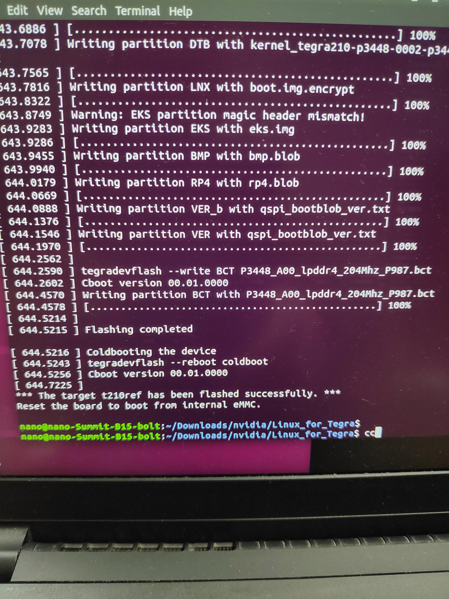

  1. Host side in optional. To run your devkit
  2. keep the recovery pin-connection during installation
  3. VM is not recommended to install JetOS, forget it
  4. an eMMC installed Nano modules, no problem.
Would you try this at the recovery mode?
$ cd Linux_for_Tegra
$ sudo ./flash.sh jetson-nano-qspi mmcblk0p1

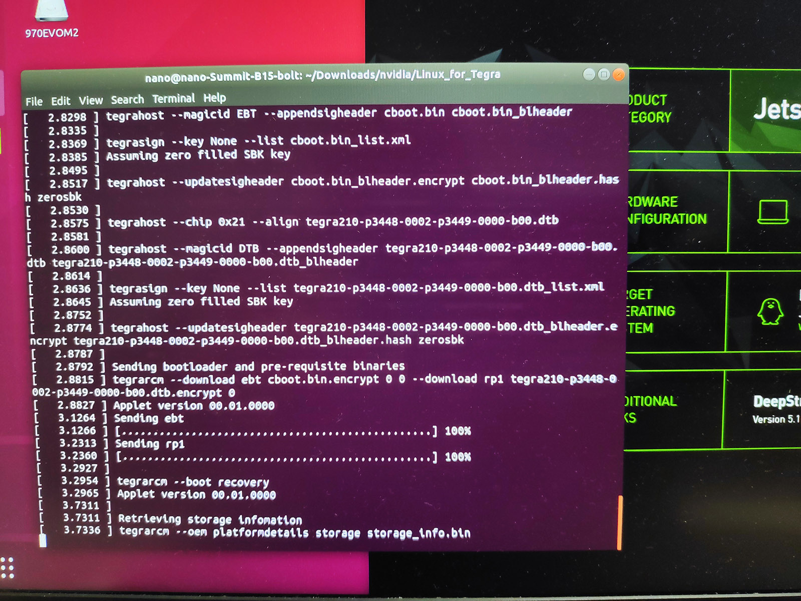

ok, so I proceed carefully and flash the nano, i think It went ok.
so now I need to reset and reboot from the nano, I will appreciate it if you could still help me a little bit with this, I search but didn’t really find anything on the reset and how to start the board.

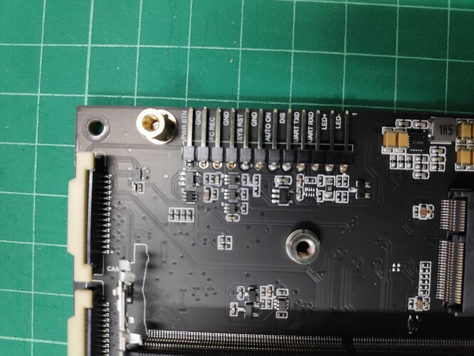

I imagine with a jumper in the back, the first 2 pins are for a power btn and GRD, so do I just have those 2 touching with a screwdriver or a jumper but before I have to reset the board, there is also a reset pin but here if you could give me the step I appreciate I read of people burning the nano by not doing it right.

  1. Power feeding
  • 5V 4A adapter via the [J25] jack: connect [J48] jumper pin
  • micro USB [J28]: open [J48]
  • by default, Jetson Nano developer kit is at an auto power-on mode. If you feed, it will be ON
To disable auto power-on mode, you need to refer developer kit user guide. Find [J50] pins.
To reset the dev kit, connect pin 7 and 8 of [J50] while running.

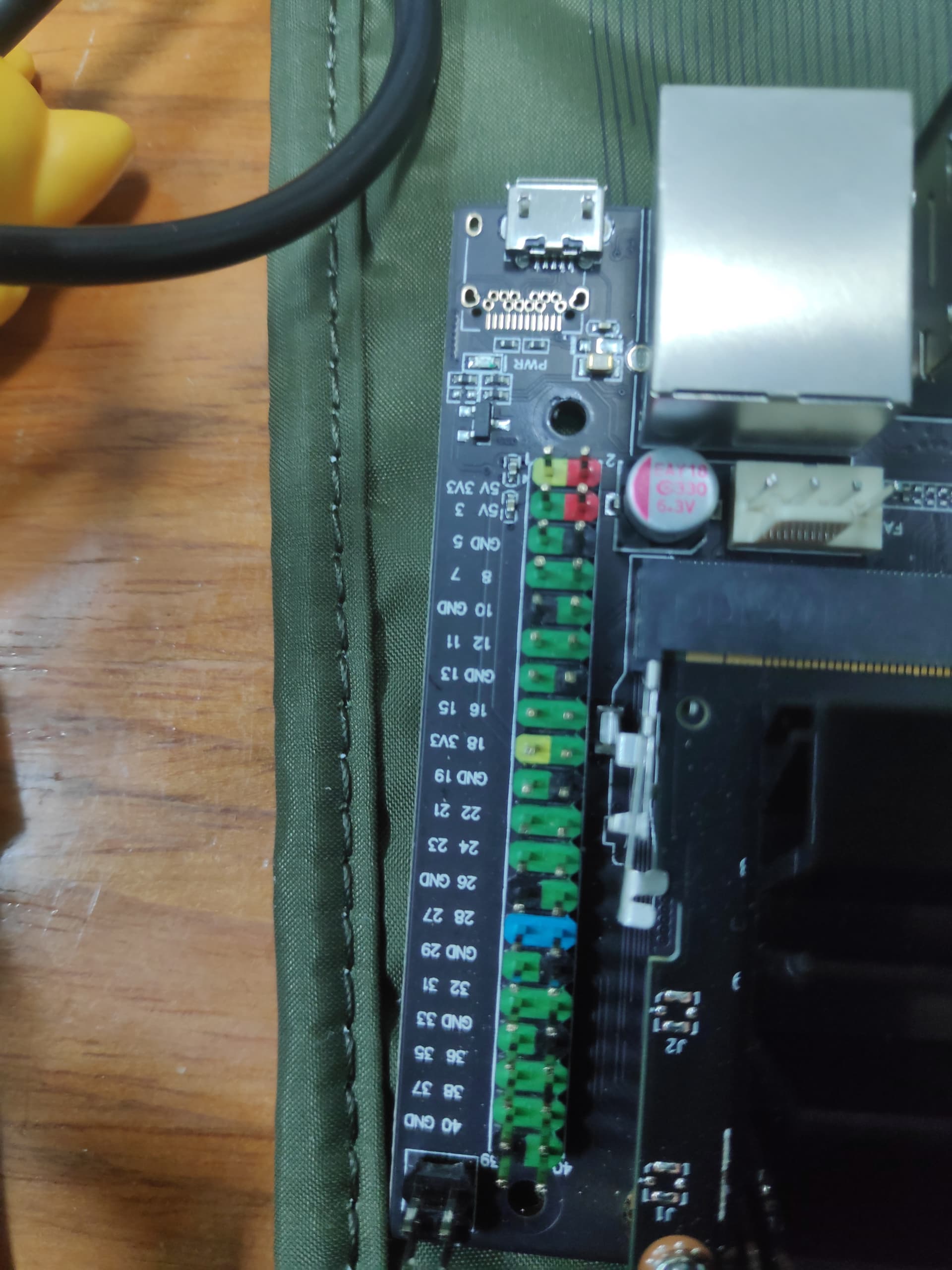

Thanks a lot for your reply so I di also research on my side and find a little bit more about my board.
  1. it is a 4 GB Jetson Nano (P3448-0020) , production module compatible. So I think the first mistake that I did every single time when using the SDK manager choosing the “Jason Nano Developer kit” instead of the first choice “Jason nano” who refer to the production module, by choosing the dev kit it seems (I didn’t verify it) the SDK manager was trying to flash the sd card and no the eMMC.
  2. because it is similar top a production board I do not have J48

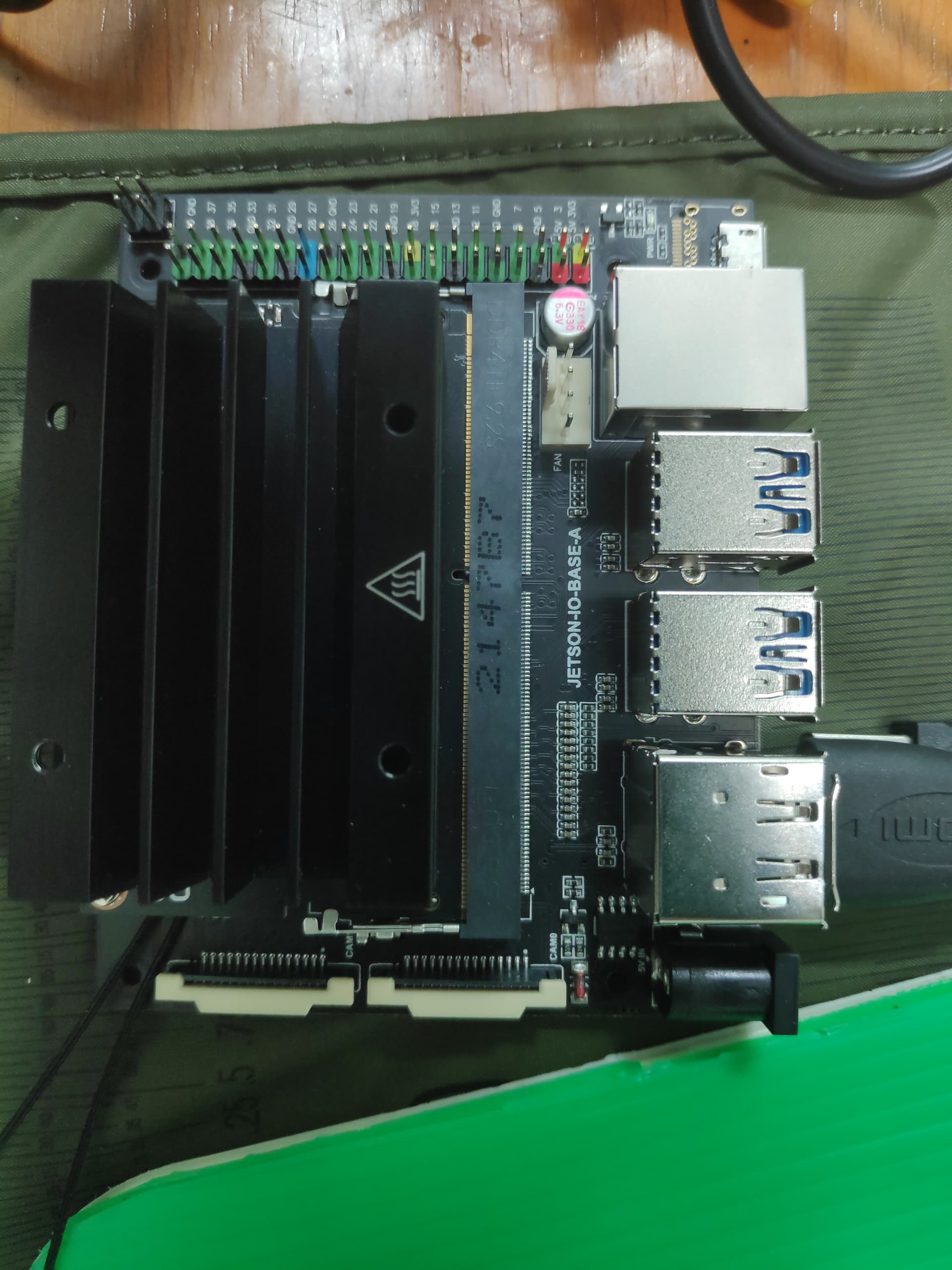

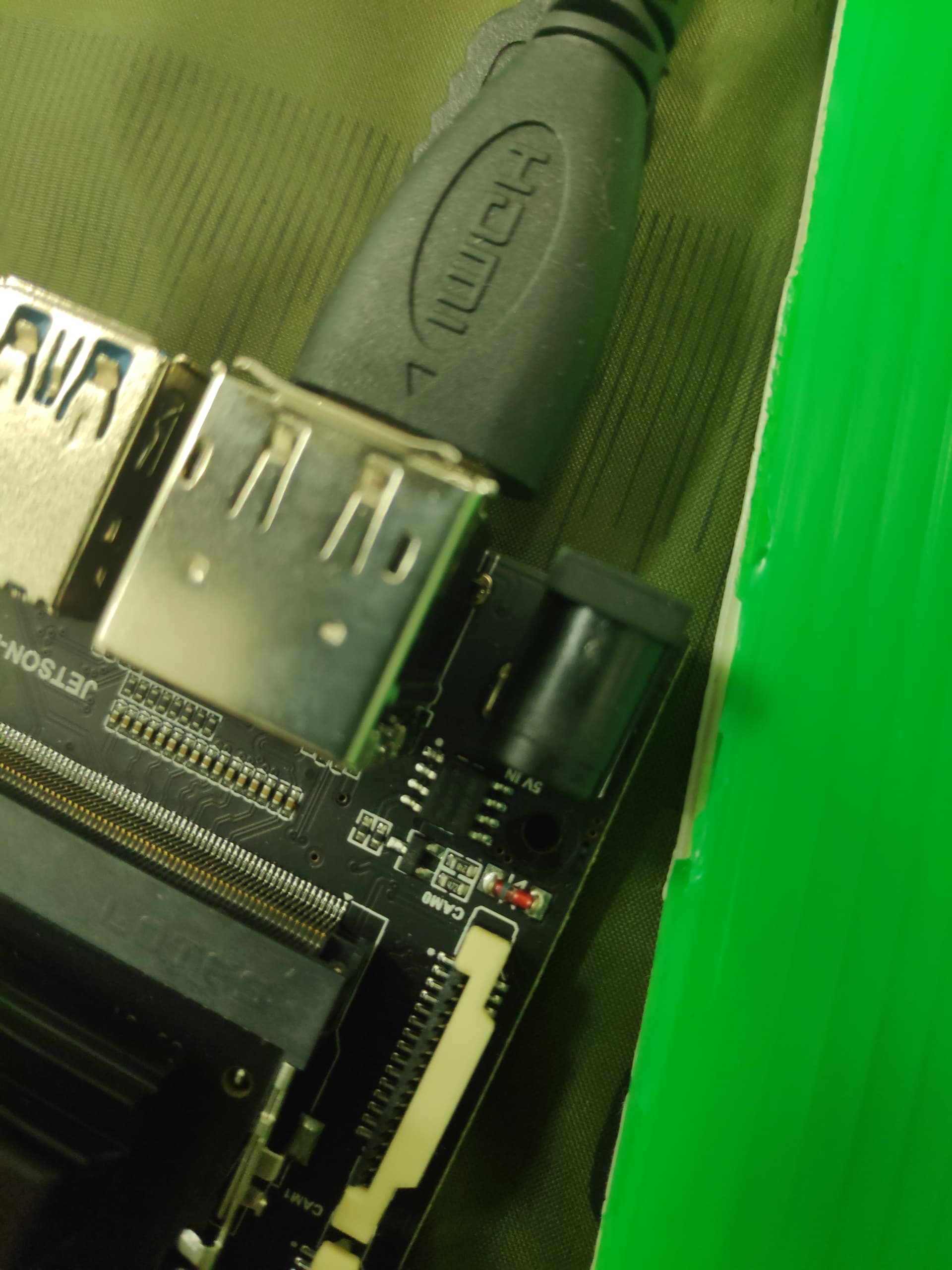

couple of pics of my board. one shows the back pins (just like the B01) and the other top view of the board, so you got a clear idea, I could show the nodule but nothing special and the module id is 900-13448-0020-000
That is not NVIDIA’s devkit, but is an alternative from a partner.
In this case, the best answer is to refer the vendor’s manual. ^^

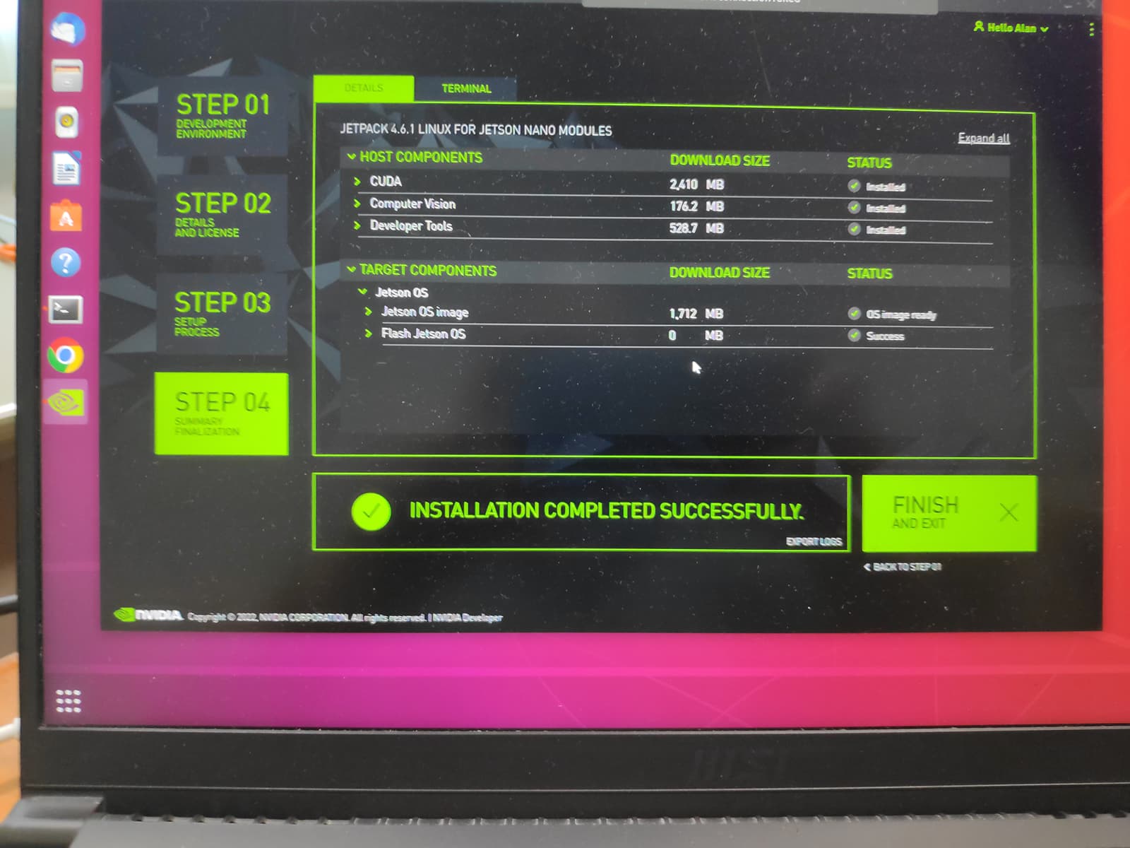

Alright done… bravo and thank’s a lot. Not having your help and guidance it would have been a lot more complicated, A couple of pics to celebrate.
The biggest problem was this bug with 18.04,
$ sudo dpkg --configure -a
setting up snapd (2.14.2~16.04) ...
and then hang forever… making it impossible to update/upgrade, and crash with each SDK manager try. I look and look for a solution to this problem and only find it today by chance, had to go into recovery mode and fix the ubuntu name server but after that, it was a different system, like that old Chinese proverb said." Don’t be afraid to go slow, just be afraid to stop, to give up" especially true in our field.
