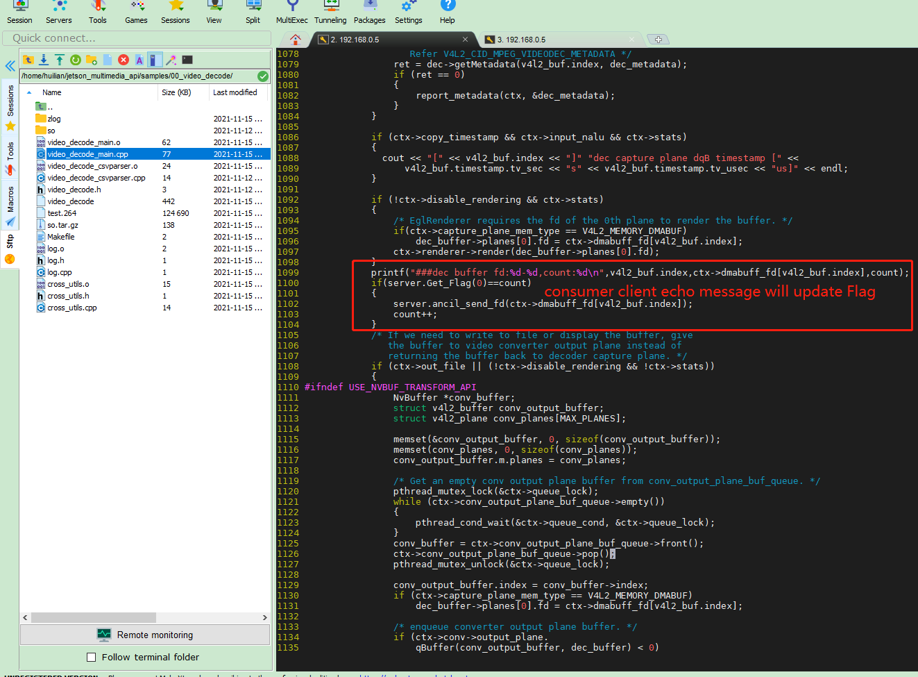

hi,danelll:
i try this test,one process send [1920x1080] yuv dmabuf data;
another process recv yuv dmabuf and NvBufferTransformEx;
but when i send frame every 30ms;and the recv process will failed at the 1011 frame later;
and i try many times,and recv process always failed at the 1011 frame later;
the error code SYNC_IOC_FENCE_INFO ioctl failed with 9

hi qwertzui11,you project NvBufferTransformEx ok ? no SYNC_IOC_FENCE_INFO error ?
My test code always occure SYNC_IOC_FENCE_INFO error after sending 1011 frames,could you help me?
thank you !!!
cross.tar.gz (113.0 KB)
In server producer ,i add "int m_nFlag[MAX_CLIENT] " to save consumer client confirm messages,and send the next new fd which is produced by [00_video_decode sample]; it also failed on 1011 frames;
I did not know how to fix this problem…
why?why always 1011 frames?what is this problem?the fd need to free or destroy?
@DaneLLL @cloundliu @edwardlu @qwertzui11 Could you help me this problem?
