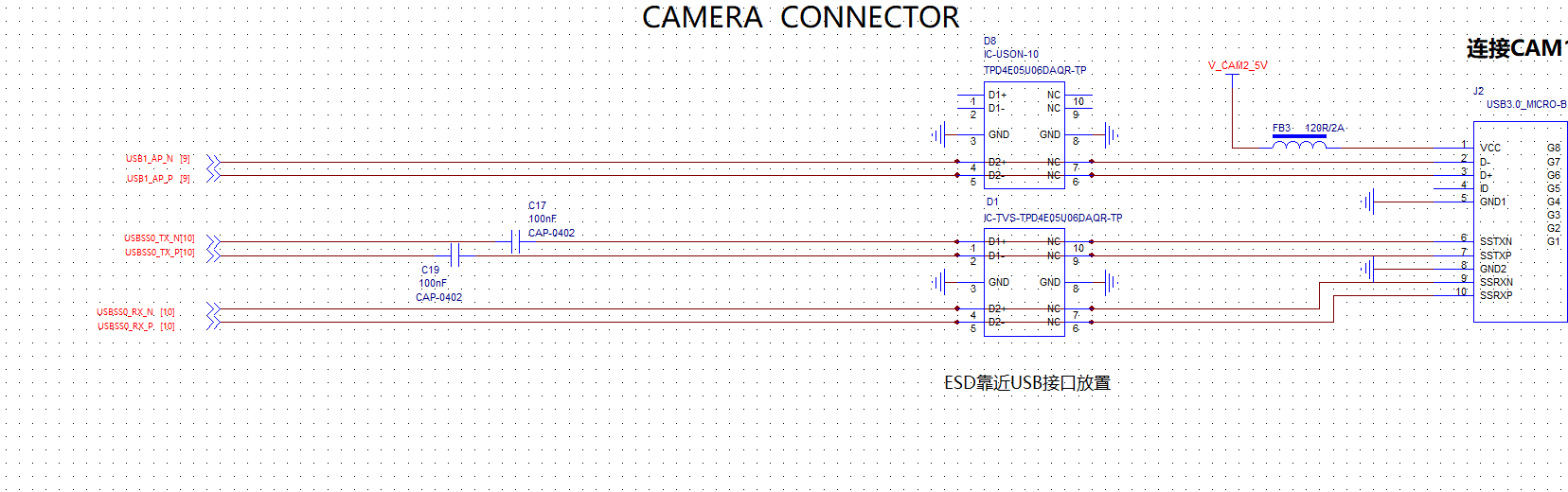

How to use USB2-1 and USB3-0 as a device mode
Here’s the schematic.
This is a modification of the device tree:

After making the above changes, i get the following message in dmesg:

What did I do wrong? Thank you, sir.

Could you convert you final dtb file back to dts and attach your full dts file here?

Could you clarify how you update your device tree? What got changed?
The error log looks like it cannot find the phys listed in your xudc.
I replaced the usb2 and usb3 lines of the xudc from usb2-0, usb3-1 to usb2-1, usb3-0 and then changed the otg mode to peripheral
Could you attach your full error log instead of partial log?
https://docs.nvidia.com/jetson/archives/r35.4.1/DeveloperGuide/text/HR/JetsonModuleAdaptationAndBringUp/JetsonAgxOrinSeries.html?highlight=usb%20role%20switch#porting-the-universal-serial-bus
You need to have usb-role-switch added so that the usb2-1 lane can get detected by driver. Only enabling it in DT is not sufficient.
do we need “usb-role-switch” when mode is peripheral ?
yes, it is needed in otg and peripheral mode. Only not needed when it is host mode.
After adding the attribute “usb-role-switch”, the error is no longer reported in dmesg.
But the device is still not found on PC

The problem here is your device tree is still wrong and may not match your board. Please check the adaptation guide again.
Also, I am not kind of all-knowing person. You should at least share your latest kernel log because I won’t tell anything out without checking the log…

The document Orin_Nano_DS.pdf said We can’t use usb2-1 as a device, and I’m wondering if this is true
