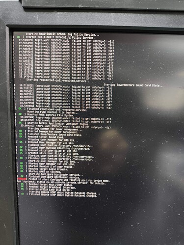

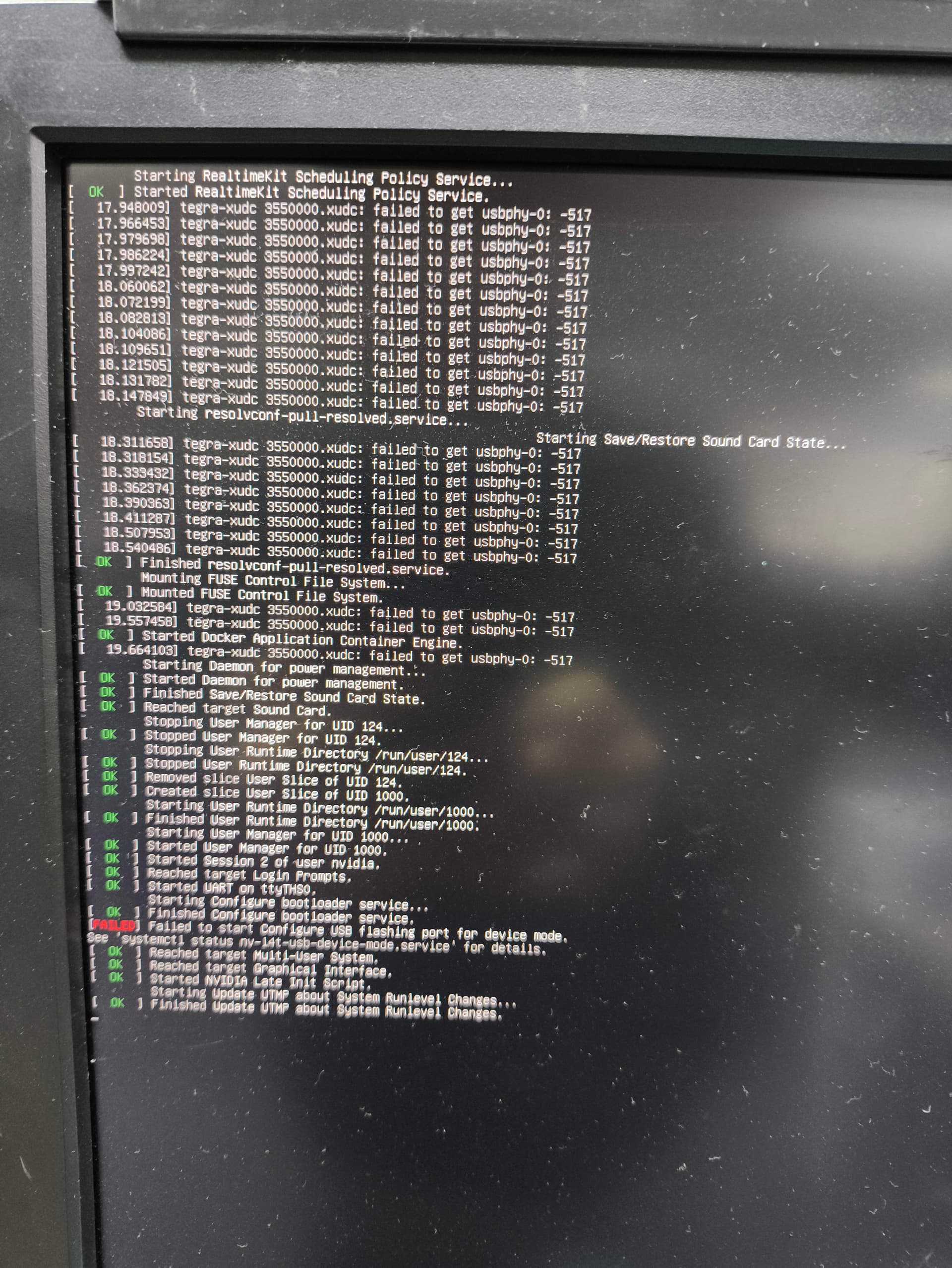

I use the Xavier NX 16G on our customer carrier board.
It could bootup and login to GUI after flash Jetpack 5.1.2 (L4T 35.4.1).
It can’t login to GUI on LCD after I ‘apt install nvidia-jetpack’ on Xavier NX, but I could login in UART port.
It show ‘Failed to start Configure USB flashing port for device mode’ message on LCD.(see Xavier-NX_fail-configure-usb-flashing-port.jpg)
[Uploading: Xavier-NX_fail-configure-usb-flashing-port.jpg…]
I also attached the kernel log(kernel_log_20240313_01.txt), and journalctl log(journalctl_log_20240313_01.txt)
kernel_log_20240313_01.txt (324.8 KB)
journalctl_log_20240313_01.txt (259.2 KB)
If I send reboot command in uart, it will reboot it, and 50% could login GUI, 50% show fail message on LCD and can’t login.
I can’t login GUI every time, and it only 50% success.
How to fix the can’t login GUI issue?

你現在的情況是UART console可以登入,但是螢幕上卡在這裡?
麻煩也拿DevKit驗證一下
在燒完 L4T R35.4.1 之後,是都沒遇到GUI無法login的問題。
但只要我 apt install nvidia-jetpack 安裝完JetPack SDK之後,就會遇到開機後,螢幕顯示一些訊息後,停住不動,但UART可以login的狀況。
不是每次上電開機都能順利進入登入畫面,卡住狀況如下影片
https://youtu.be/t6HXGDhVVUA
不確認是否為JetPack SDK造成的,但這樣操作的流程是可以100%重現問題,請問可以由 log 去縮小可能的問題點嗎?
麻煩抓一下可以登入跟不能登入兩種情況下的console log還有dmesg
還有用DevKit和5.1.3驗證一下
