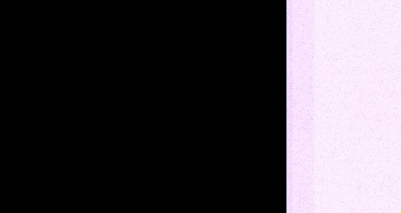

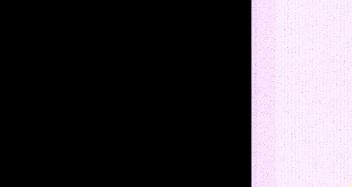

Hi Everyone,
we are using sony IMX678 on a hisilicon soc and met image issues. I am wondering if anyone can give any suggestions.
We used IMX678 DOL-HDR with 2 line to 1 mode on hi3559V200 and the image is abnormal as below.
the sensor has been brought up but image is wrong. we tried 2 frames to 1 and it works normal.
The log is as below. Since the values are all zero, it seemed the lanes are correct but image just can’t get right.
Huawei LiteOS # cat /proc/umap/ cat /proc/umap/mipi_rx
cat [FILE]
Huawei LiteOS # cat /proc/umap/mipi_rx
Huawei LiteOS #
Module: [MIPI_RX], Build Time[Jan 8 2021, 19:48:04]
-----MIPI LANE DIVIDE MODE---------------------------------------------------------------------------------------------
MODE LANE DIVIDE
0 4
-----MIPI DEV ATTR-----------------------------------------------------------------------------------------------------
Devno WorkMode DataRate DataType WDRMode ImgX ImgY ImgW ImgH
0 MIPI X1 RAW12 VC 0 0 3840 2160
-----MIPI LANE INFO-----------------------------------------------------------------------------------------------------
Devno LaneID
0 0, 1, 2, 3
-----MIPI PHY DATA INFO------------------------------------------------------
PhyId LaneId PhyData MipiData LvdsData
0 0, 1, 2, 3, 0xc3,0xfe,0xc2,0x83 0x93,0x0c,0x0d,0x8c 0x30,0xfa,0xb4,0xa0
-----MIPI DETECT INFO----------------------------------------------------
Devno VC width height
0 0 3840 2160
0 1 3840 2160
0 2 0 0
0 3 0 0
-----PHY CIL ERR INT INFO---------------------------------------------
PhyId Clk2TmOut ClkTmOut Lane0TmOut Lane1TmOut Lane2TmOut Lane3TmOut Clk2Esc ClkEsc Lane0Esc Lane1Esc Lane2Esc Lane3Esc
0 0 0 0 0 0 0 0 0 0 0 0 0
-----MIPI ERROR INT INFO 1-----------------------------------------------------------
Devno Ecc2 Vc0CRC Vc1CRC Vc2CRC Vc3CRC Vc0EccCorrct Vc1EccCorrct Vc2EccCorrct Vc3EccCorrct
0 0 0 0 0 0 0 0 0 0
-----MIPI ERROR INT INFO 2-----------------------------------------------------------
Devno Vc0Dt Vc1Dt Vc2Dt Vc3Dt Vc0FrmCrc Vc1FrmCrc Vc2FrmCrc Vc3FrmCrc
0 0 0 0 0 0 0 0 0
-----MIPI ERROR INT INFO 3-----------------------------------------------------------
Devno Vc0FrmSeq Vc1FrmSeq Vc2FrmSeq Vc3FrmSeq Vc0BndryMt Vc1BndryMt Vc2BndryMt Vc3BndryMt
0 0 0 0 0 0 0 0 0
-----MIPI ERROR INT INFO 4-----------------------------------------------------------
Devno DataFifoRdErr CmdFifoRdErr CmdFifoWrErr DataFifoWrErr
0 0 0 0 0
-----ALIGN ERROR INT INFO--------------------------------------
Devno FIFO_FullErr Lane0Err Lane1Err Lane2Err Lane3Err
0 0 0 0 0 0

Hi Markus,thank you very much for your attention to our bug issue :-))
The hardware we are using is not Nvidia but Hisilicon Hi3559V200. We can’t find resourceful help in China so I am trying my luck here.
So hisilicon provide 2 kinds of WDR. One is 2 frame to 1 and we have worked it out. But ISP suggested such mode will cause moving shadows. He suggested using 2to1_LINE WDR mode. But our system engineer met image issue as I showed above.
The linear mode also works fine.
We are wondering if anybody know if IMX678 supports 2to1_line mode?

Thanks for your reply and I am sorry for the disturb.
I checked all posts about IMX678 and did not find if it supports 2to1 Line mode.
We would appreciate it a lot if anybody has experience with IMX678 DOL HDR with 2to1 line mode.
