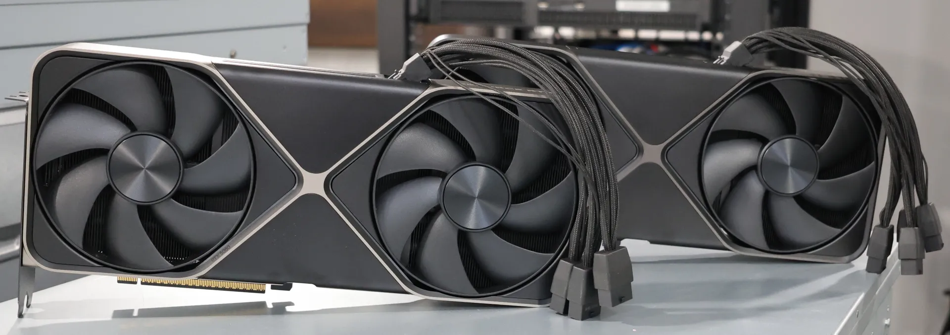

Install of RTX 5070 Ti problematic on Linux
Hello, I just received an RTX 5070 Ti.
My motherboard’s bios is up to date.
I tested Debian 12.10, Devuan 5.0.1, Mint 22.1, Ubuntu 25.04, Fedora 42, Manjaro 24.0.5 and Windows 11.
Only Manjaro 24.0.5 and Windows 11 installed without any problems.
Other operating system installers refuse to start, whether in graphical mode, text mode, or safe mode.
My base installation of Debian 12, installed with an RTX 3080 and updated with the proprietary NVIDIA-Linux-x86_64-570.133.07.run driver before upgrading my graphics card, failed to boot with the RTX 5070 Ti, even though everything worked perfectly with my RTX 3080 ?! Debian freezes during the “loading initial ramdisk” sequence.
I’ve never seen an Nvidia card so difficult to install in Linux ?!
I would like to stay on a Debian-based OS… Can anyone help me ?
