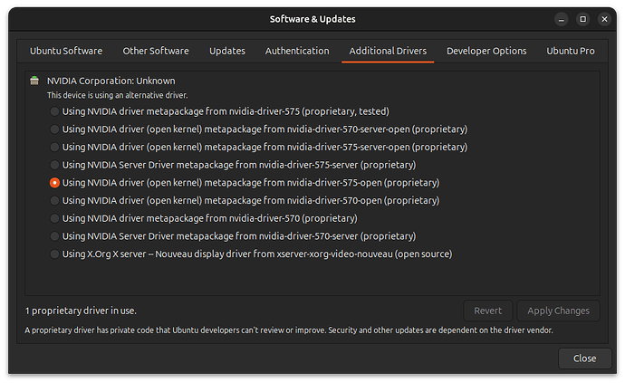

I had installed driver nvidia-driver-575 in Ubuntu 24.04 and restarted the system:

However, the nvidia-driver-575 - distro non-free recommended driver does not detect the RTX 5060 Ti GPU.
$ nvidia-detector
nvidia-driver-575
$ nvidia-smi
No devices were found

I noticed the following issues in my kernel log. nvidia-drm failed and saying the it requires use of the NVIDIA open kernel modules. :

[   62.702880] NVRM: The NVIDIA GPU 0000:01:00.0 (PCI ID: 10de:2d04)
               NVRM: installed in this system requires use of the NVIDIA open kernel modules.

How should I resolve this issue? Even though the monitor that is connected to the GPU via the HDMI port shows images (i.e i don’t have a black screen issue).
System info:
I just explored changing the driver to nvidia-driver-575-open - distro non-free and restarting the system:
This change of driver seems to have resolved my issue:

[   22.322351] nvidia 0000:01:00.0: vgaarb: VGA decodes changed: olddecodes=io+mem,decodes=none:owns=none
[   22.342650] nvidia-modeset: Loading NVIDIA UNIX Open Kernel Mode Setting Driver for x86_64  575.64.03  Release Build  (dvs-builder@U22-I3-H04-03-5)  Wed Jun 25 18:07:44 UTC 2025
[   22.362262] [drm] [nvidia-drm] [GPU ID 0x00000100] Loading driver
[   23.973376] [drm] Initialized nvidia-drm 0.0.0 for 0000:01:00.0 on minor 0
[   24.040275] nvidia 0000:01:00.0: [drm] fb0: nvidia-drmdrmfb frame buffer device
$ sudo dmesg | grep NVIDIA
[   22.332400] NVRM: loading NVIDIA UNIX Open Kernel Module for x86_64  575.64.03  Release Build  (dvs-builder@U22-I3-H04-03-5)  Wed Jun 25 18:17:57 UTC 2025
$ nvidia-smi
Mon Jul 21 18:52:21 2025
| NVIDIA-SMI 575.64.03              Driver Version: 575.64.03      CUDA Version: 12.9     |
|   0  NVIDIA GeForce RTX 5060 Ti     Off |   00000000:01:00.0  On |                  N/A |
|  0%   38C    P8              8W /  180W |      67MiB /  16311MiB |     30%      Default |
|                                         |                        |                  N/A |
| Processes:                                                                              |
|  GPU   GI   CI              PID   Type   Process name                        GPU Memory |
|        ID   ID                                                               Usage      |
|    0   N/A  N/A            2630      G   /usr/lib/xorg/Xorg                       45MiB |
I am not sure why the recommended driver failed to work but the non-recommended open driver version worked.
In any case, I hope this new info can help other users with the same issue that I have encountered.
Because like it was said many times in this forum RTX 5000 series cards require open driver, won’t work with closed one.
@thesourcehim In this case, the command ubuntu-drivers devices ought to have recommended nvidia-driver-575-open - distro non-free instead of nvidia-driver-575 - distro non-free. Maybe the relevant people can look into this matter.
