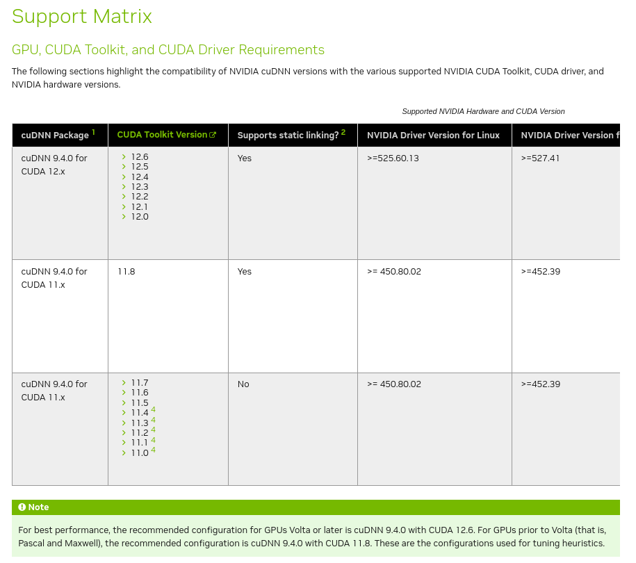

Hi, I am trying to install cudnn9 to match with my CUDA 11.8 installed.
as per the link, it says cudnn9 is compatible with CUDA 11.8: link
I am facing an issue whereby the steps provided in the link below cause the system to install cudnn9.4.0 with CUDA 12.6:
How can I install cudnn 9.4.0 to be statically linked with CUDA11.8 for my Jetson Orin Nx ?

We don’t have a combination of cuDNN 9 + CUDA 11.8.
JetPack 5 only supports the CUDA package upgrade.
For other packages, ex cuDNN or TensorRT, the upgradable feature is added in the JetPack 6.
Please note that the JetPack 6 supports CUDA 12.2+, no CUDA 11 is available.
could you please confirm and clarify what the contents in the links I sent in relation to the compatibility of the libraries?
cuDNN9 corresponds to cuDNN 9.4.0. correct?
link1: Installing cuDNN on Linux — NVIDIA cuDNN v9.4.0 documentation
from the support matrix cuDNN 9.4.0 + 11.x , where it shows 11.8 as compatible
link2: Support Matrix — NVIDIA cuDNN v9.4.0 documentation

Hi @AastaLLL
I’m seeing some inconsistencies which were still not addressed. The document mentions CUDA 11.X is compatible with cuDNN 9.4.0, please clarify, otherwise please confirm the document requires an update.
I understand as you mention to upgrade to JetPack 6.0 to get cuDNN 9.x support. However this does not solve my current issue as I require Jetpack 5.X which seems to be associated with ubuntu 20.04. Is there a way to get ubuntu 20.04 with Jetpack 6.0 via the SDK manager? I was not able to find a way of specifying the version.
I require the ubuntu 20.04 as it matches with my current ROS 1 version (ros noetic).
appreciate your insight on this, so I know a reliable source for documentation referencing.
Unfortunately, we don’t have a cuDNN 9 package for JetPack 5 users.
Our internal team will verify the document again.
