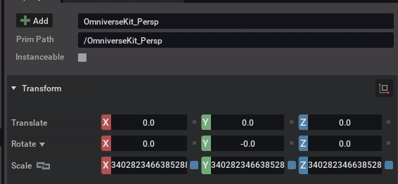

The function set_camera_view docu seems broken in the new release
The view jumps to some random large scale values.

I found out that this behavior happens when the camera is pointing directly to the ground.

If I set target=np.array(1, 1.5, 0.5) the camera params are fine again and it is looking to the ground.
Thanks, I can confirm the bug, as a temporary workaround you can use a value such as [1, 1.000001, 0.5]when looking on the Z axis.
