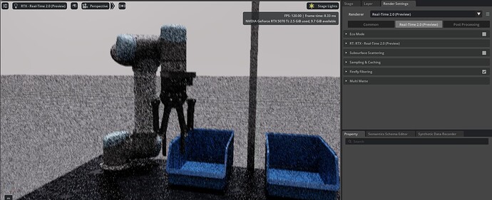

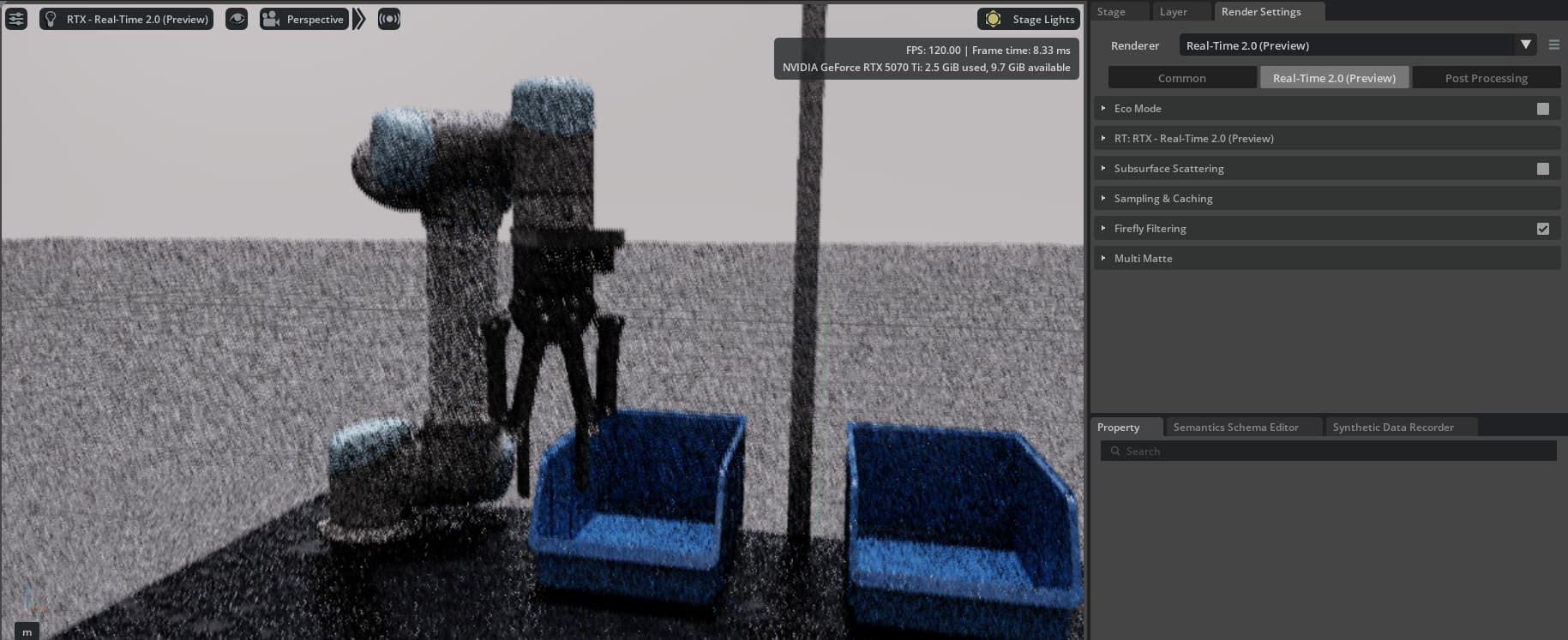

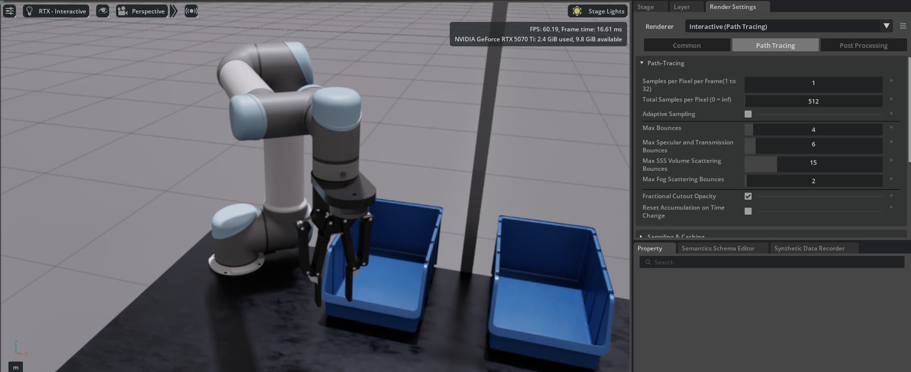

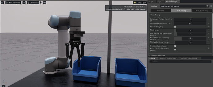

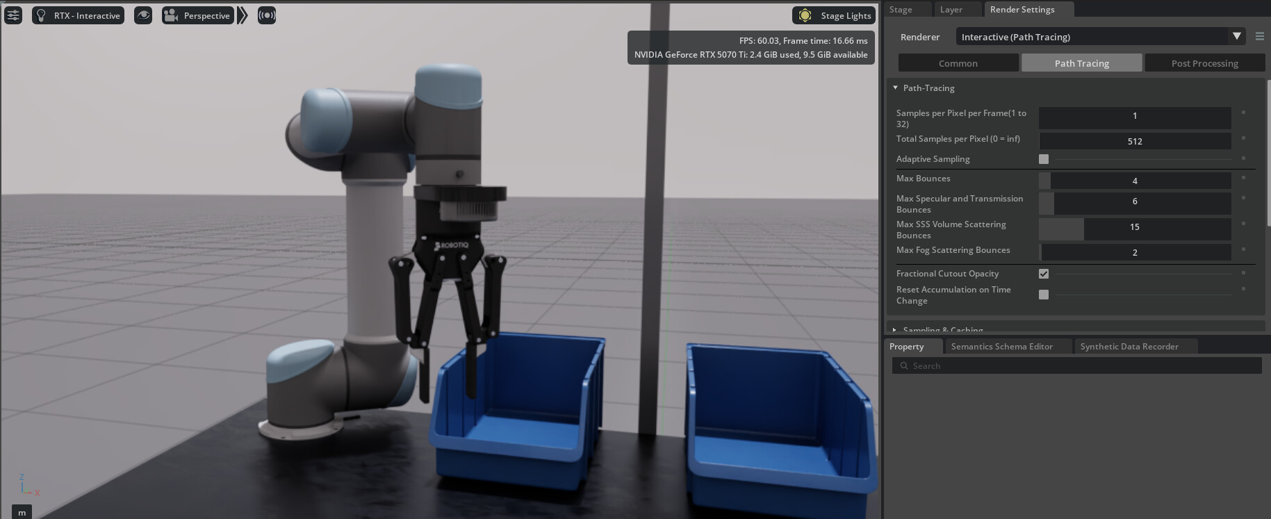

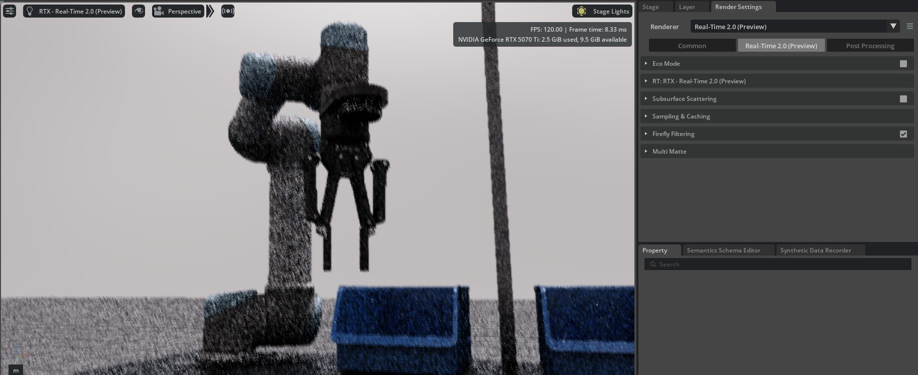

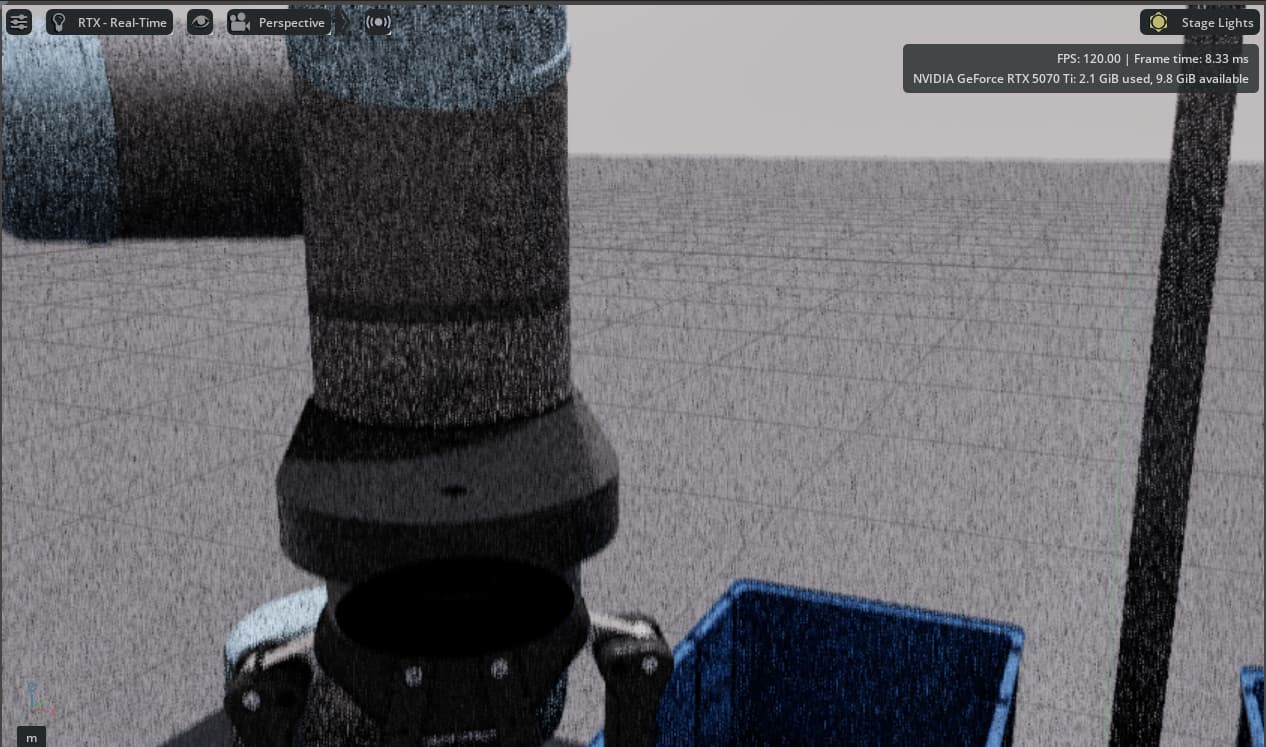

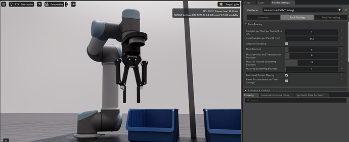

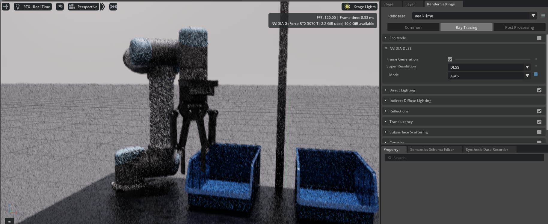

✨ Whimsical Rendering Problem ✨
In Isaacsim, the orientation of prims sometimes changes depending on which rendering option you choose.
EDIT:
Seems like its more to do with the material of the camera glass (in black) being projected through every other object making it seem like it is changing poses. Why is this the case?
