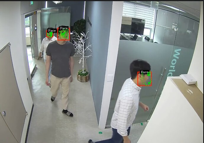

Thanks for advice the model worked on a sample input video but as you can see that the output is not appropriate so what are the possible reasons and what can i do now?
a
This could be another issue about the inference, not the hardware decoder issue. About this new issue, could you file a new topic? We try to make sure that one topic only solves the same issue, so that others can refer to it easily. Thanks
