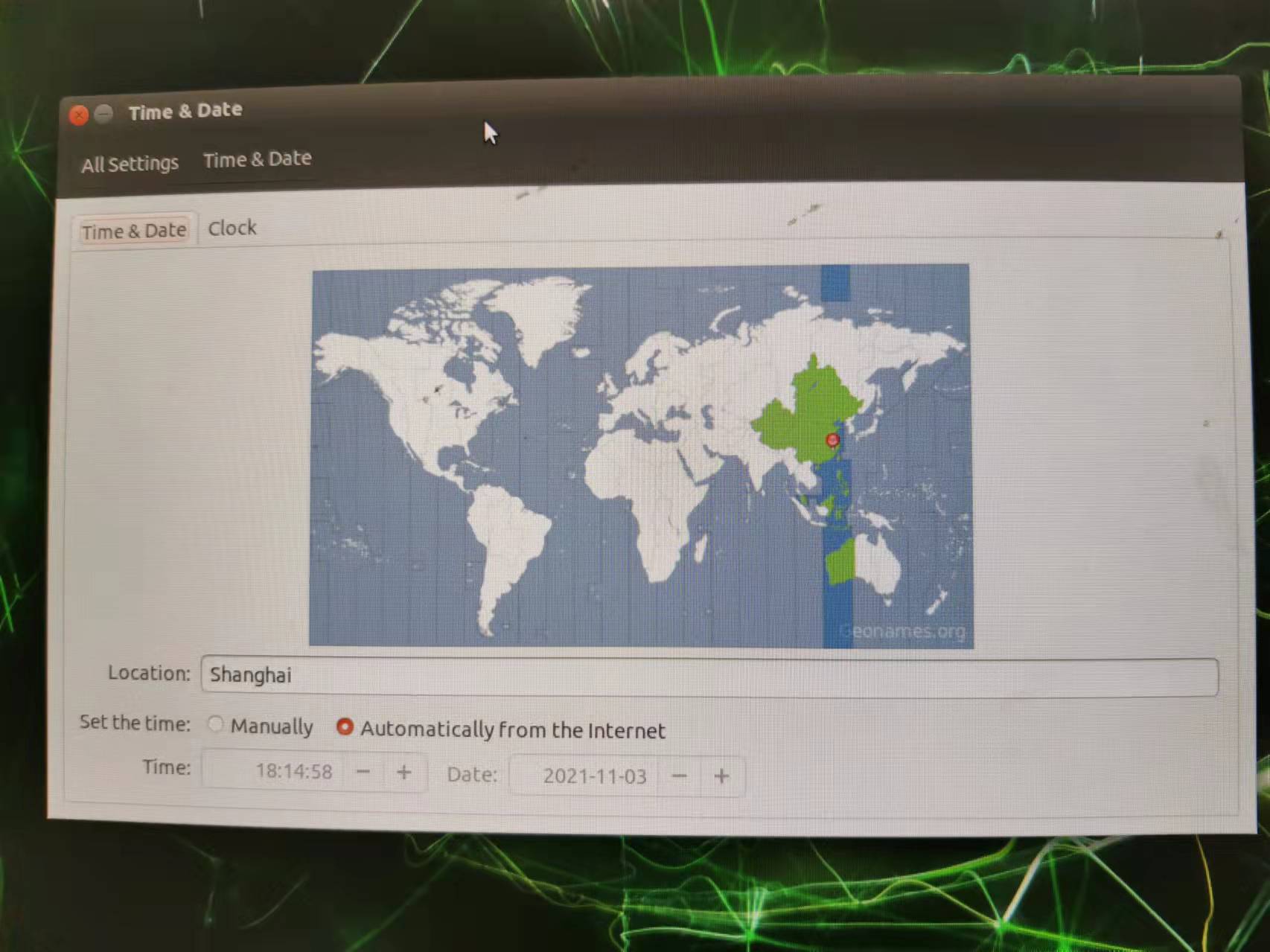

I executed ‘sudo apt install ntpdate’, and also downloaded and executed this shell script: jetcard/jetson_add_ntp_server.sh at master · NVIDIA-AI-IOT/jetcard · GitHub , but the error is still there, this has blocked me to install other software.
My time & date setting is as the following:
hello akachen,
we cannot reproduce the issue locally, this should related to the server issue,
i.e. https://repo.download.nvidia.cn/
could you please try revise the repo for verification.
thanks

Hi user30659,
Please open the apt source configuration file:
$ sudo vi /etc/apt/sources.list.d/nvidia-l4t-apt-source.list
And check the command would be:
deb https://repo.download.nvidia.com/jetson/common r32.6 main
deb https://repo.download.nvidia.com/jetson/t194 r32.6 main
Run ‘apt update’ again. Thanks!
Thanks, now ‘sudo apt update’ can run well, I did nothing since yesterday after I reported this case, as you said, it looks like your server has problem yesterday.
You can close this case now, thanks.
