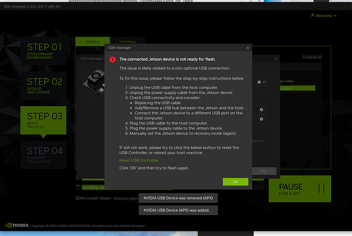

Hello, I’m trying to install Linux on my Jetson Orin Nano 4GB development board using Manager CDK and Jetpack 6.2.1, but I’m having trouble flashing it. So, I tried a manual installation using the Ubuntu terminal. I flashed the OS on my Jetson Orin Nano 4GB development board using the following command: sudo ./flash.sh jetson-orin-nano-devkit nvme0n1p1
However, flashing always fails with the following error message:
ERROR: might be timeout in USB write..
Parsing board information failed.
Here are the steps I tried:
  1. Use a 1m USB-C to USB-C data cable that complies with the USB 3.1 Gen 2 standard.
  2. Disable the USB auto-suspend feature.
    echo -1 > /sys/module/usbcore/parameters/autosuspend
  3. I swapped out several USB ports and verified that the Jetson entered recovery mode (lsusb output: 0955:7033).
  4. I’m running Ubuntu 22.04 LTS on my host PC.
However, the flash failed.
I’ve attached the following two log files:
  1. jetson_flash_log.txt – Flash attempt log
  2. jetson_board_info_log.txt – Board information read log
I’m wondering if this issue occurs with JetPack 6.2.1 and the Orin Nano 4GB. I’ve tried everything I can, including replacing the cable, but the flash continues to fail. Thank you for your advice. Thanks for reading this long post.

Hi David, thank you so much for your reply. I read it carefully. I did what you said, but I’m still getting the same error. I don’t think it’s a cable issue. I bought a ton of cables. I’m desperate to flash
Thank you so much for your kind and detailed reply. I followed every step carefully, exactly as you described — downloading the correct BSP and rootfs, extracting them, running l4t_flash_prerequisites.sh and apply_binaries.sh, and finally executing the l4t_initrd_flash.sh command with the correct parameters.
However, I’m still getting the same USB timeout error when it tries to communicate with the board. I’ve tested with multiple cables, including data-capable ones, and I don’t think the issue is related to the cable itself. I’ve spent a lot of time and tried many combinations, but I still haven’t been able to flash successfully.
I’m really desperate to get this working and would greatly appreciate any further advice or troubleshooting steps. Is there anything else I might be missing?
Thanks again for your help.

Please record the serial console log for us to review.
Also press EXPORT LOGS button in sdk manager to upload the flashing logs.
SDKM_logs_2025-07-31_21-53-36.zip (523.1 KB)
Hi David! Thank you so much for your reply. Here’s the log from the Manager SDK
Sorry, but the zip file you provided isn’t what I was looking for.
Please refer to the video and record the serial log accordingly.
Thank you for your attention! I have already completed it.
