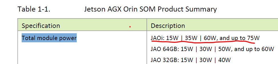

In my custom board design based on ORIN AGX Industrial SOM, we are designing own thermal solutions. For that can you please let me know what is the static power dissipation we need to consider ?
Do you have application wise power data since i am not using all the functionality of ORIN like - we are not using csi at all,
I want power dissipation data as per use case not for SC7. I asked about the static power dissipation or you can say nominal/typical power dissipation.
The real power consumption depends on your use case as it is very different between different use cases. You should run your use case on devkit first to get the data.
