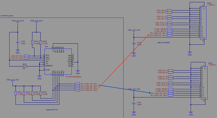

I am using a Jetson Nano on my custom-designed board and have connected an IMX219 camera module. The camera appears to be detected (ls /dev/video* and dmesg | grep imx219 show it), but I am unable to get any video output using GStreamer or v4l2-ctl.
Steps I have tried so far:
  • Checked the camera connection and ribbon cable.
  • Looked for error messages in dmesg output.
  • Verified that the camera is listed with v4l2-ctl --list-devices.
  • Tested the same camera on a different Jetson Nano, and it worked fine.

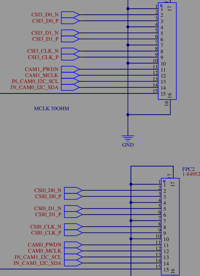

However, I still can’t get any video. Could this be a device tree (DTB) configuration issue? Do I need to modify the reset-gpios settings?

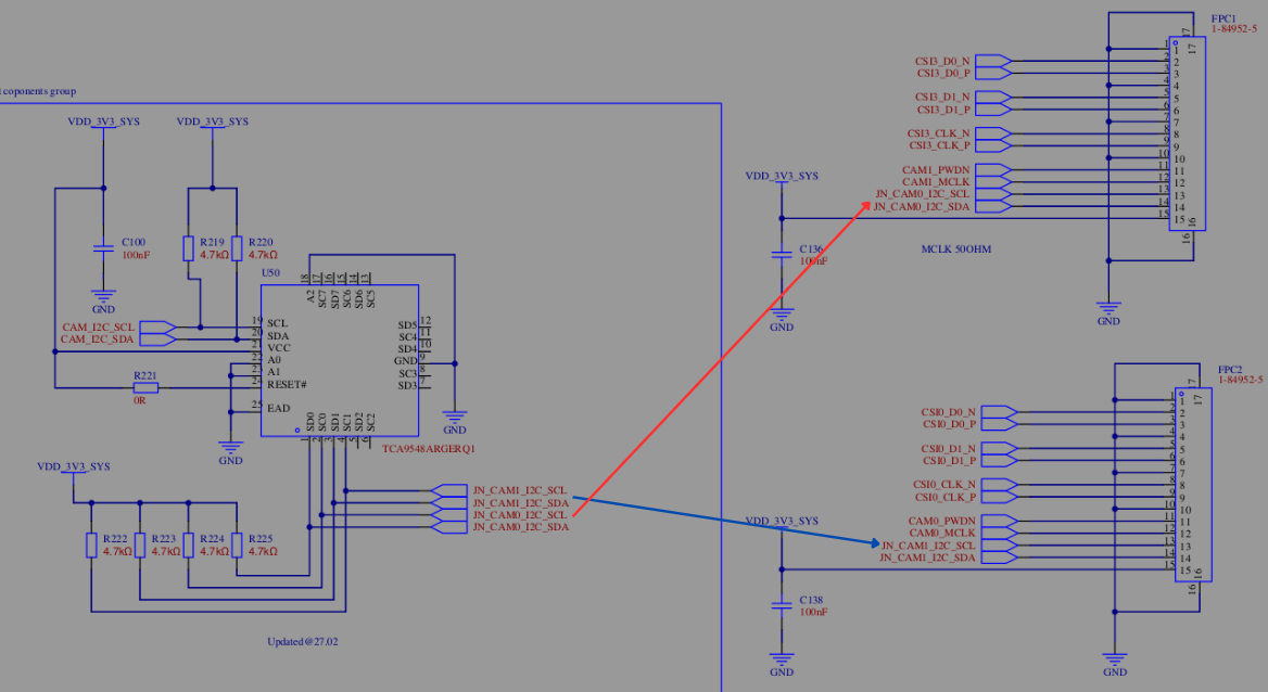

I am using a TCA9548 MUX for CSI, so I modified the device tree (DTS) by replacing PCA9544 references with PCA9548.

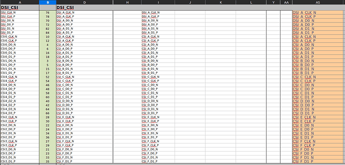

However, I am unsure if there are other changes I need to make in the DTS file, such as:

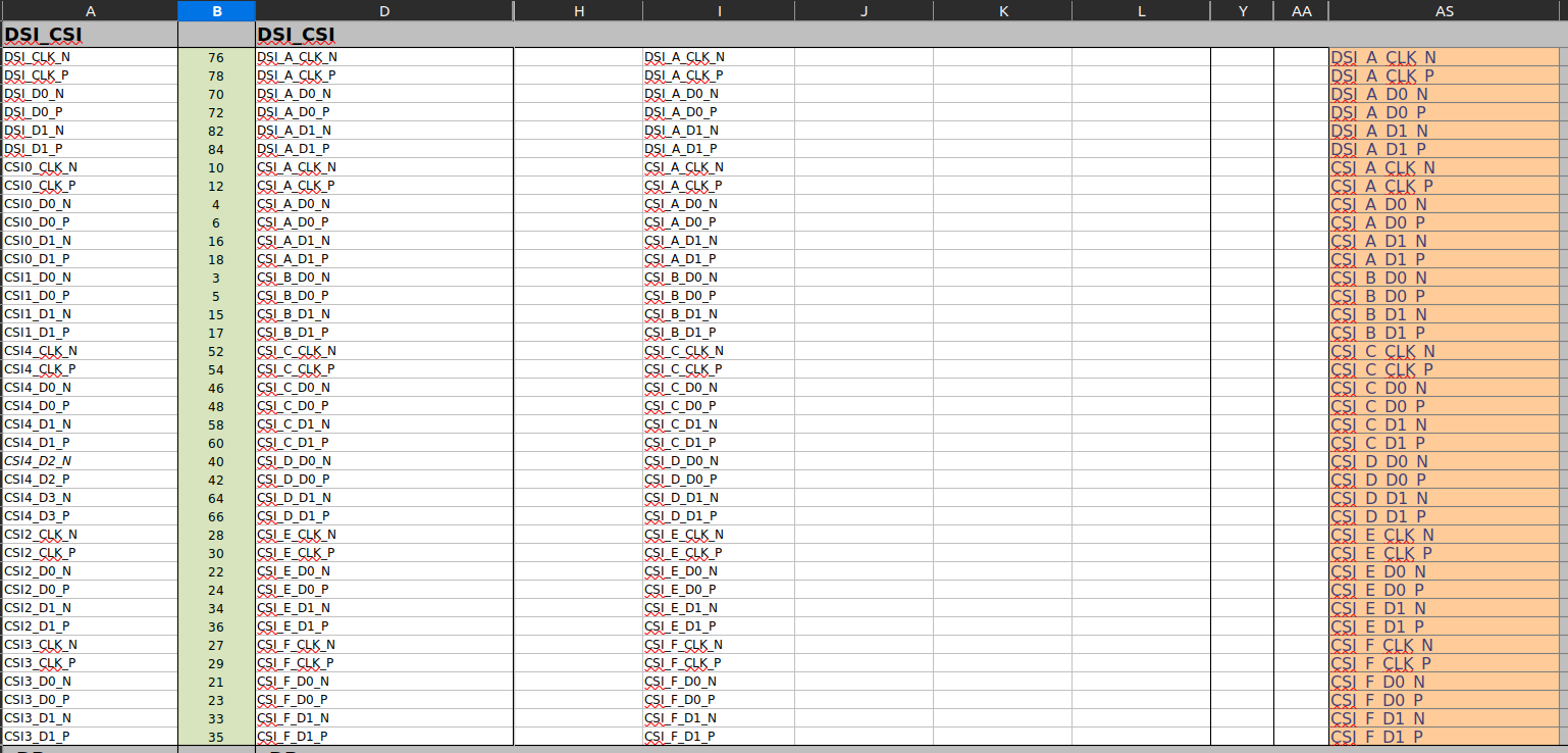

  • Where can I check serial_a, serial_e definitions?
  • What do the values in reset-gpios = <0x5b 0x97 0x0>; mean?
  • Is my reset-gpios setting correct, or how should I determine it?
I am not entirely sure about these details. Any suggestions or resources would be greatly appreciated.

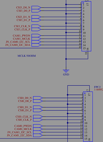

I will also attach the relevant device tree files and circuit schematics below.

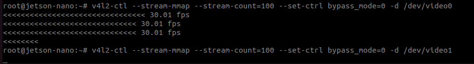

v4l2-ctl --stream-mmap --stream-count=100 --set-ctrl bypass_mode=0 -d /dev/video0
<<<<<<<<<<<<<<<<<<<<<<< 21.18 fps
v4l2-ctl --stream-mmap --stream-count=100 --set-ctrl bypass_mode=0 -d /dev/video1
nothing

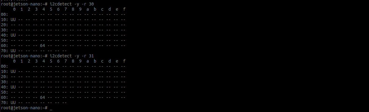

i2cdetect -l
i2c-3	i2c       	7000c700.i2c                    	I2C adapter
i2c-13	i2c       	i2c-6-mux (chan_id 6)           	I2C adapter
i2c-1	i2c       	7000c400.i2c                    	I2C adapter
i2c-11	i2c       	i2c-6-mux (chan_id 4)           	I2C adapter
i2c-8	i2c       	i2c-6-mux (chan_id 1)           	I2C adapter
i2c-6	i2c       	Tegra I2C adapter               	I2C adapter
i2c-4	i2c       	7000d000.i2c                    	I2C adapter
i2c-14	i2c       	i2c-6-mux (chan_id 7)           	I2C adapter
i2c-2	i2c       	7000c500.i2c                    	I2C adapter
i2c-12	i2c       	i2c-6-mux (chan_id 5)           	I2C adapter
i2c-0	i2c       	7000c000.i2c                    	I2C adapter
i2c-9	i2c       	i2c-6-mux (chan_id 2)           	I2C adapter
i2c-10	i2c       	i2c-6-mux (chan_id 3)           	I2C adapter
i2c-7	i2c       	i2c-6-mux (chan_id 0)           	I2C adapter
i2c-5	i2c       	7000d100.i2c                    	I2C adapter

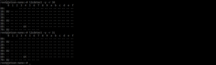

i2cdetect -y -r 7
     0  1  2  3  4  5  6  7  8  9  a  b  c  d  e  f
00:          -- -- -- -- -- -- -- -- -- -- -- -- --
10: UU -- -- -- -- -- -- -- -- -- -- -- -- -- -- --
20: -- -- -- -- -- -- -- -- -- -- -- -- -- -- -- --
30: -- -- -- -- -- -- -- -- -- -- -- -- -- -- -- --
40: UU -- -- -- -- -- -- -- -- -- -- -- -- -- -- --
50: -- -- -- -- -- -- -- -- -- -- -- -- -- -- -- --
60: -- -- -- -- 64 -- -- -- -- -- -- -- -- -- -- --
70: UU -- -- -- -- -- -- --
i2cdetect -y -r 8

dts file: dts_file.txt (310.2 KB)
board circuit:
SCH_PX4-JN_SCHEMATIC_2025-04-09.pdf (337.7 KB)
Looks like video0 is working.
Check the programing guide for the port-index/serial_* …
@ShaneCCC Video0 seems to be working, but when I try to get an image, I get no output. Similarly, when I try video1, there is no output either. What steps should I take to resolve this issue?
In the schematic, CAM0 is connected to CAM1_PWDN, and CAM1 is connected to CAM0_PWDN. Could this connection cause an issue? Also, I have a question about the GPIO addresses in the following DTS file:

From different sources, I found that usually 0x97 and 0x98 should be swapped, but when I did that, the cameras started being detected. What exactly do 0x97 and 0x98 correspond to, and how should I interpret them when making such changes?
I feel like I need to adjust the addresses in the endpoint and reset-gpios sections.
Thank you in advance for your response.
Here’s the define.
#define CAM1_PWDN		TEGRA_GPIO(S, 7)
21 #define CAM2_PWDN		TEGRA_GPIO(T, 0)
22 #define CAM_I2C_MUX TEGRA_GPIO(I, 0) // NFC_EN GPIO
23
24 / {
25 	cam_i2cmux {
26 		compatible = "i2c-mux-gpio";
27 		#address-cells = <1>;
28 		#size-cells = <0>;
29 		mux-gpios = <&gpio CAM_I2C_MUX GPIO_ACTIVE_HIGH>;
30 		i2c-parent = <&i2c7>;
31 		i2c@0 {
32 			reg = <0>;
33 			#address-cells = <1>;
34 			#size-cells = <0>;
35 			rbpcv2_imx219_a@10 {
36 				reset-gpios = <&gpio CAM1_PWDN GPIO_ACTIVE_HIGH>;
37 			};
38 		};
39 		i2c@1 {
40 			reg = <1>;
41 			#address-cells = <1>;
42 			#size-cells = <0>;
43 			rbpcv2_imx219_e@10 {
44 				reset-gpios = <&gpio CAM2_PWDN GPIO_ACTIVE_HIGH>;
45 			};
46 		};
47 	};
I have started to understand the DTS file a bit, and I appreciate your help, @ShaneCCC . Now, I am facing the following issue: As seen in the circuit above, I am using the CAM1_PWDN outputs and the CSI3 interface. When I check the pin_mux diagram, I see that it corresponds to CSI_F. Based on this, I believe that the port-index values in the endpoint sections of the code need to be adjusted. By default, 0x4 and 0x0 are used. Since video0 uses 0x0, communication can be established, but video1 is not receiving any data. I suspect that the issue is due to the 0x4 value in this section. How should I modify this part?

CSI0 should be CSI-A and port-index should be 0
CSI3 should be CSI-C and port-index should be 3
@ShaneCCC When I check the pin_mux structure, CSI3 corresponds to F. However, as you suggested, I set the port-index to 3, but nothing changed. How can I diagnose the problem more effectively?

The port-index map to CSI lanes.
port index: 0 1 2 3 4 5
CSI lane: A B C D E F
@ShaneCCC As you suggested, I set the port-index to 3, but there was no change in the result. When I run the command v4l2-ctl --stream-mmap --stream-count=100 --set-ctrl bypass_mode=0 -d /dev/video1, I don’t get any output.

Please check the kernel message for the sensor probe.
sudo dmesg | grep -i imx219
@ShaneCCC Here are the outputs
root@jetson-nano:~# sudo dmesg | grep -i imx219
[    0.227821] DTS File Name: tegra210-nano-cti-NGX004-RPI-IMX219-2CAM.dts
[    0.432193] DTS File Name: tegra210-nano-cti-NGX004-RPI-IMX219-2CAM.dts
[    4.145191] imx219 30-0010: tegracam sensor driver:imx219_v2.0.6
[    4.177642] imx219 31-0010: tegracam sensor driver:imx219_v2.0.6
[    4.953227] vi 54080000.vi: subdev imx219 31-0010 bound
[    4.953230] vi 54080000.vi: subdev imx219 30-0010 bound
root@jetson-nano:~# v4l2-ctl --list-devices
vi-output, imx219 31-0010 (platform:54080000.vi:0):
	/dev/video0

The reg should be 0 for i2c@0 and should be 1 for i2c@1?
				i2c@0 {
					#address-cells = <0x1>;
					#size-cells = <0x0>;
					status = "okay";
					reg = <0x1>;
					i2c-mux,deselect-on-exit;
@ShaneCCC I’d like to explain the reason behind this by referring to the schematic. In the schematic, the I2C0 output of the MUX is connected to CAM1, and the I2C1 output is connected to CAM0. Instead of changing every instance of port = 0 to 1, and port = 1 to 0 in the code, I found it more reasonable to simply swap the I2C addresses.
I applied the change you suggested, and now both video0 and video1 are visible. I can get video from video0, but I’m still unable to receive any image from video1.
dts file:
jetson_nano_dts.txt (310.3 KB)
I’m able to exchange data via video0, and video1 has finally started to appear, but I’m not receiving any image or response from video1 Still, having video1 show up is progress. Thank you for your help so far. At this point, is there any way to figure out why I can’t get any data from video1?
Should be the port-index = 3 instead of 4

@ShaneCCC
root@jetson-nano:~# v4l2-ctl --stream-mmap --stream-count=100 --set-ctrl bypass_mode=0 -d /dev/video0
<<<<<<<<<<<<<<<<<<<<<<< 21.19 fps
<<<<<<<<<<<<<<<<<<<<< 21.20 fps
root@jetson-nano:~# v4l2-ctl --stream-mmap --stream-count=100 --set-ctrl bypass_mode=0 -d /dev/video1

I’ve made the correction you mentioned, but I’m still not receiving any data. : (
@ShaneCCC Thank you for your help! After following the steps you provided, I set port-index = 5 and serial = "f", and it worked. I really appreciate your assistance in helping me resolve the issue.
We did it! It’s working perfectly without any issues.
