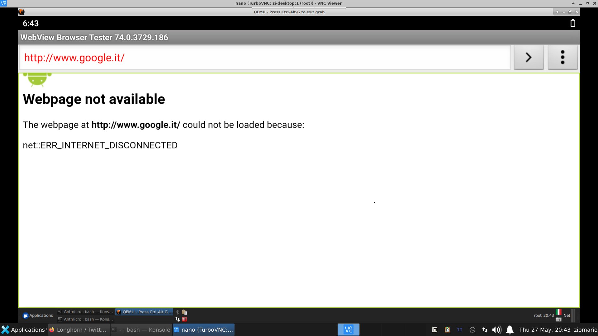

at the end,after several months of research,we (me and @rreddy78) have been able to boot Android by Antmicro :

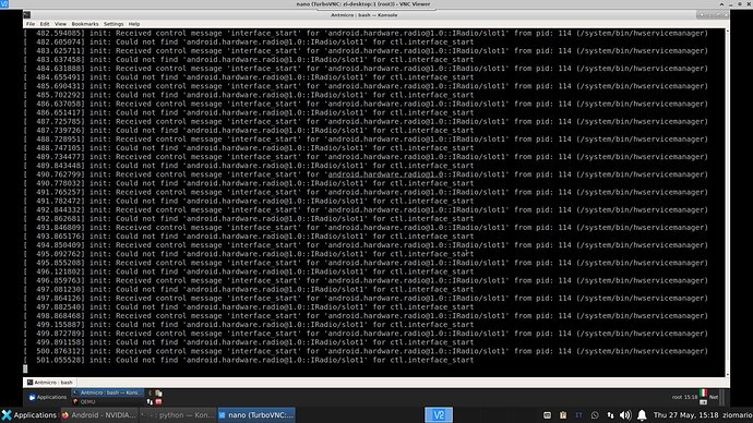

it boots even if a cyclic error happens :
the real problem now is that it is unabled to grab the connection to the net :
this is the configuration of qemu which works (except for the net)
