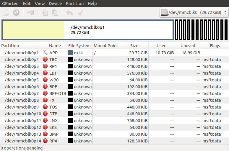

Jetson Nano sd card partitions can not extend
Also, even using gparted, can’t move any of those teeny partitions to the end of the filespace, probably due to the “filesystem” in those 13 little partitions not being recognized.

I did some study and found the reason, why original /etc/systemd/nvresizefs.sh script doesn’t work properly.
The SDK manager builds the following partition sequence by default in 16G space:
/dev/mmcblk0p1  :name="APP"
/dev/mmcblk0p2  :name="TBC"
/dev/mmcblk0p3  :name="RP1"
/dev/mmcblk0p4  :name="EBT"
/dev/mmcblk0p5  :name="WB0"
/dev/mmcblk0p6  :name="BPF"
/dev/mmcblk0p7  :name="BPF-DTB"
/dev/mmcblk0p8  :name="FX"
/dev/mmcblk0p9  :name="TOS"
/dev/mmcblk0p10 :name="DTB"
/dev/mmcblk0p11 :name="LNX"
/dev/mmcblk0p12 :name="EKS"
/dev/mmcblk0p13 :name="BMP"
/dev/mmcblk0p14 :name="RP4"
The main partition for data is “APP” and it goes the first one in the list.
So actually the rest of 13 partitions blocks it from expanding to a free space of sdcard.
The straight forward solution I made is to move all other partitions [mmcblk0p2…p14] to the end of the sdcard.
After that original script resizes the APP partition on the first boot automatically.
If somebody want to go this way, I can put an automatic script that relocates partitions to the end of the drive. Just leave here a message.
But the core problem should be fixed by Nvidia’s developers, simply moving APP partition to the end of partition list, i.e. /dev/mmcblk0p14

My card is 32G and being able to move partitions 2 till 14 to the end of the diskspace would be very nice so I can extend partition 1.

Hi!
I don’t think you get the point in 16G image that comes from the start.
16G image is very convenient for backup and flashing. One can make “small” backup of full installation, once SDK manager has finished and all additional software and config done. And it’s important that it’s only 16G partition size backup. When you dump 128G card with DD and zip it, the size doesn’t matter much, though read speed is no 100M/s. But when you flash 128G image instead of 16G image it takes you 8 times longer, and in my case the write speed was about 4M/s. And I have several JNano kits for education project and have to keep them cloned.
So I would even suggest to remove auto-expansion script from the startup scripts. Just provide information to user how to run it.
SDKmanager is nice looking tool, why just not to fix the partition creation order in your scripts. It’s just a 30 minutes fix from your developers or even less.

# Extending root (APP) partition
sgdisk -d 1 -n 1:"${p_st[1]}":0 -c 1:"${p_n[1]}" -t $p:"${p_t[1]}" -u $p:"${p_u[1]}" /dev/mmcblk0
partprobe /dev/mmcblk0
# Resizing file system
resize2fs /dev/mmcblk0p1
sleep 0.5
size="$(cat /sys/block/mmcblk0/mmcblk0p1/size)"
echo "New size of root file system is $(($size*512/1000/1000/1000))G"
# Removing partition table backup
rm -f mmc_orig.ptt
instructions: (copy from script)
open terminal
  open a new file for edit  `nano jn_sd_resize.sh`
  paste the code, save and exit nano
  call `chmod +x jn_sd_resize.sh`
  run script with sudo `sudo ./jn_sd_resize.sh`
The script runs on jetson nano
No reboot needed
Restore original partition with command ‘sudo sgdisk --load-backup=mmc_orig.ptt /dev/mmcblk0’, if the script fails before “Resizing root file system…” message
I tested the script with 64G and 128G cards
It adopts to the card size automatically
Thank you so much @Lufus the script works great!!
My partitions now look like this (sudo sfdisk -d /dev/mmcblk0):
label: gpt
label-id: 00000000-0000-0000-0000-000000000000
device: /dev/mmcblk0
unit: sectors
first-lba: 40
last-lba: 62333918
table-length: 14
/dev/mmcblk0p1 : start=          40, size=    62326288, type=0FC63DAF-8483-4772-8E79-3D69D8477DE4, uuid=8A2ADA49-3FD8-4F7C-B138-6BAAE7774F7C, name="APP"
/dev/mmcblk0p2 : start=    62326328, size=         256, type=EBD0A0A2-B9E5-4433-87C0-68B6B72699C7, uuid=0A5E07F4-9725-4C97-9B33-6727E2FEF753, name="TBC"
/dev/mmcblk0p3 : start=    62326584, size=         896, type=EBD0A0A2-B9E5-4433-87C0-68B6B72699C7, uuid=3448C881-CACC-4495-8523-340BDE3AFB06, name="RP1"
/dev/mmcblk0p4 : start=    62327480, size=        1152, type=EBD0A0A2-B9E5-4433-87C0-68B6B72699C7, uuid=4132DC35-27A1-4AD2-864B-1D08A4648A78, name="EBT"
/dev/mmcblk0p5 : start=    62328632, size=         128, type=EBD0A0A2-B9E5-4433-87C0-68B6B72699C7, uuid=3890BB3E-95F5-4EFE-87FC-3732C0390C05, name="WB0"
/dev/mmcblk0p6 : start=    62328760, size=         384, type=EBD0A0A2-B9E5-4433-87C0-68B6B72699C7, uuid=34BAC152-7522-4E08-81CA-D72D1D7A0973, name="BPF"
/dev/mmcblk0p7 : start=    62329144, size=         768, type=EBD0A0A2-B9E5-4433-87C0-68B6B72699C7, uuid=0FDC96F9-F479-4B19-A4FB-8D50BA2BF077, name="BPF-DTB"
/dev/mmcblk0p8 : start=    62329912, size=         128, type=EBD0A0A2-B9E5-4433-87C0-68B6B72699C7, uuid=20634AB4-472F-4432-95EC-662F1DE5882C, name="FX"
/dev/mmcblk0p9 : start=    62330040, size=         896, type=EBD0A0A2-B9E5-4433-87C0-68B6B72699C7, uuid=6532865C-391D-40CD-95AD-CF5F518E906F, name="TOS"
/dev/mmcblk0p10 : start=    62330936, size=         896, type=EBD0A0A2-B9E5-4433-87C0-68B6B72699C7, uuid=6D64D042-E0B1-4736-B38D-8843C398AD21, name="DTB"
/dev/mmcblk0p11 : start=    62331832, size=        1536, type=EBD0A0A2-B9E5-4433-87C0-68B6B72699C7, uuid=7BCCAB7D-B038-4EBC-A2D3-A828B387FF3C, name="LNX"
/dev/mmcblk0p12 : start=    62333368, size=         128, type=EBD0A0A2-B9E5-4433-87C0-68B6B72699C7, uuid=698ED7DA-1F68-40C6-97EC-893518931F22, name="EKS"
/dev/mmcblk0p13 : start=    62333496, size=         160, type=EBD0A0A2-B9E5-4433-87C0-68B6B72699C7, uuid=7FC4B55E-E91F-47C1-98CC-2B27B0767F34, name="BMP"
/dev/mmcblk0p14 : start=    62333656, size=         257, type=EBD0A0A2-B9E5-4433-87C0-68B6B72699C7, uuid=35CA5E41-9759-4503-8DF0-88273AF5A645, name="RP4"
I commented out the last line in your script where the backup file is removed, but it was not necessary to revert. Very happy now being able to use the additional space on the SD card :-) Thx again!
@Lufus the script really works great for me too,
Thanks so much!
