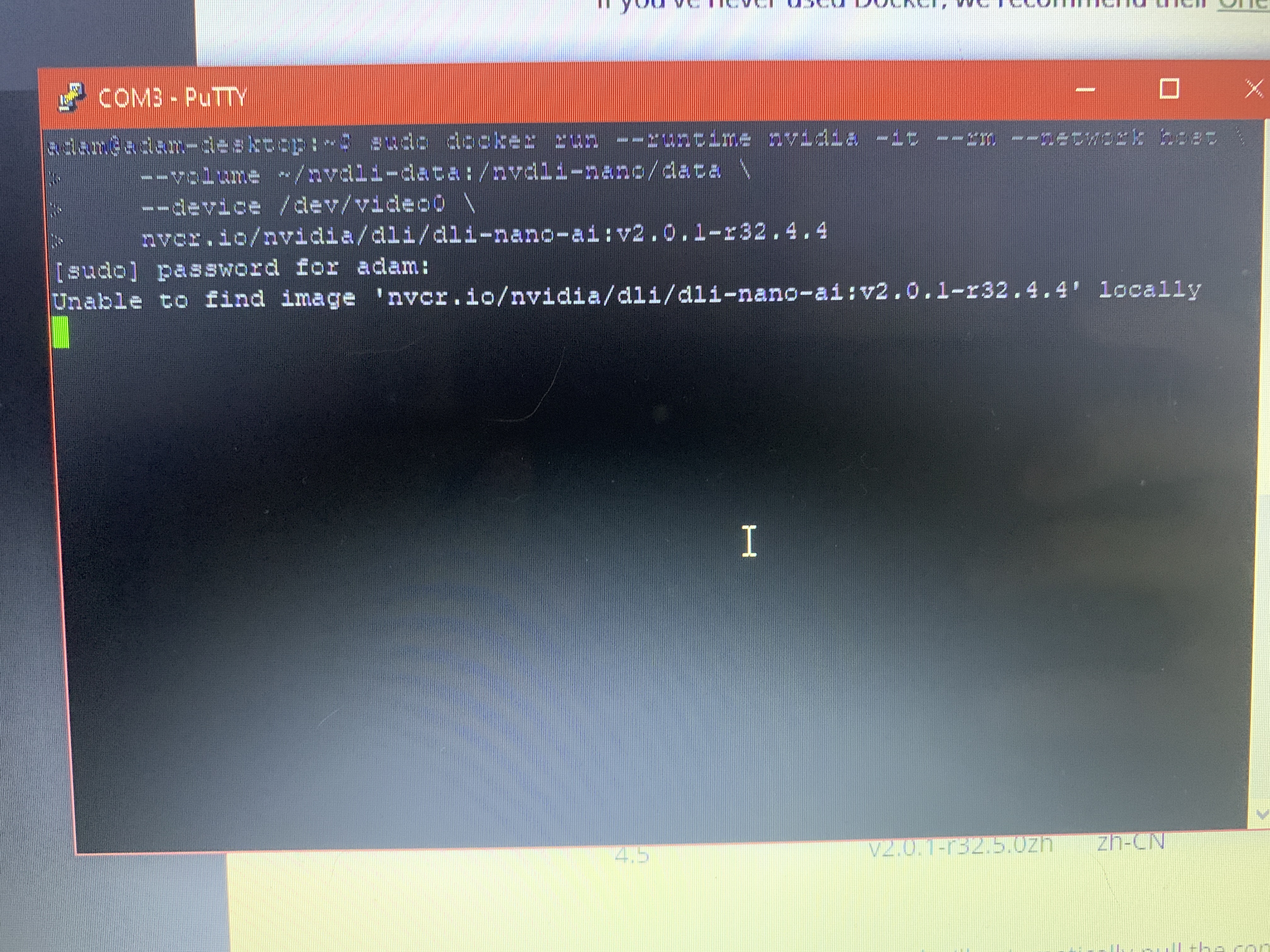

So I was following the videos for the headless device mode setup and everything was fine until I got to the part where it says to run the docker container when I try it it says enter password then I enter it then I just says unable to find image. Did I download something wrong?

But when I try to run it it just shows this:

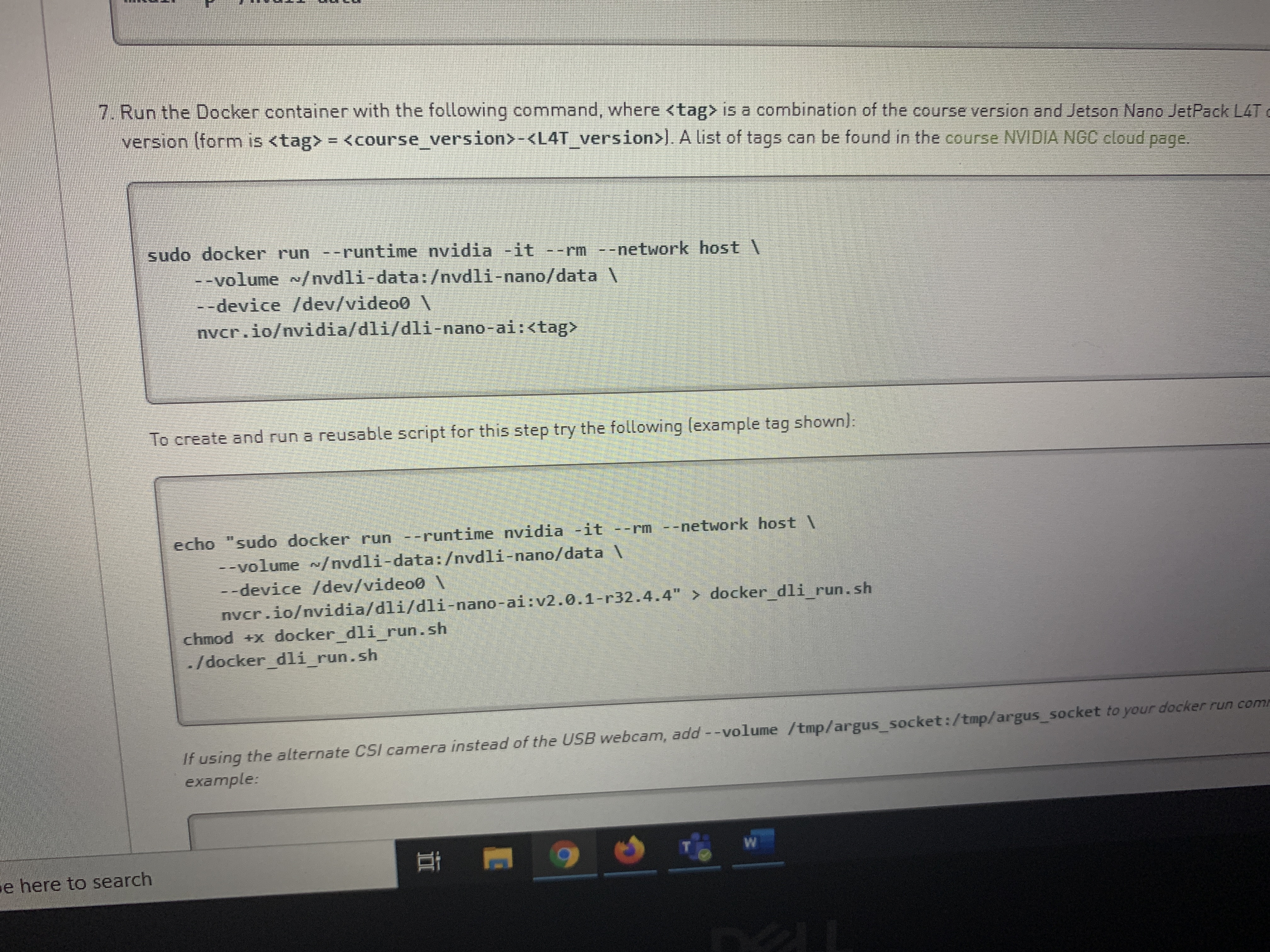

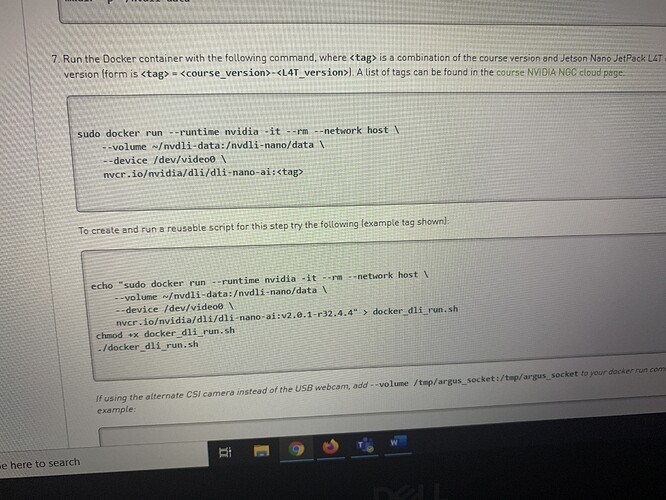

these are the codes I am trying to run

Hi @groot80123, are you able to do:
sudo docker pull nvcr.io/nvidia/dli/dli-nano-ai:v2.0.1-r32.4.4
If so, try re-running the sudo docker run ... command you used above and see if it starts this time.

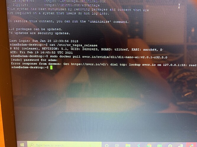

Also, can you check which version of JetPack-L4T you are running with cat /etc/nv_tegra_release? If it is L4T R32.5.0, use the nvcr.io/nvidia/dli/dli-nano-ai:v2.0.1-r32.5.0 container instead.
This is what it says
@groot80123, I can’t see the whole error message from screenshot, but it appears to be some connection issue. If you reboot and try again does it work now?
This is what it shows I have rebooted it and it shows the same thing
What am I doing wrong
Are you able to ping google.com from your Nano in your SSH session there?
If not, the internet connection sharing through your PC may not be working, and I recommend connecting your Nano to your network router via ethernet or wifi to pull the container.
