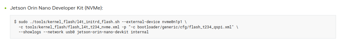

Please use initrd flash to flash instead of the command you are using now.
Hi, thank you for the fast response. So I tried:
sudo ./tools/kernel_flash/l4t_initrd_flash.sh --external-only --network usb0 --external-device nvme0n1 -c tools/kernel_flash/flash_l4t_external.xml jetson-orin-nano-devkit-nvme internal
sudo ./tools/kernel_flash/l4t_initrd_flash.sh jetson-orin-nano-devkit internal
sudo ./tools/kernel_flash/l4t_initrd_flash.sh jetson-orin-nano-devkit-nvme internal
sudo ./tools/kernel_flash/l4t_initrd_flash.sh jetson-agx-orin-devkit internal
sudo ./tools/kernel_flash/l4t_initrd_flash.sh jetson-agx-orin-devkit-as-nx-16gb internal
but the problem persists, would I be missing something?
Your command is still wrong.
Copy and paste command just from here.
https://docs.nvidia.com/jetson/archives/r36.4/DeveloperGuide/IN/QuickStart.html#to-flash-the-jetson-developer-kit-operating-software
