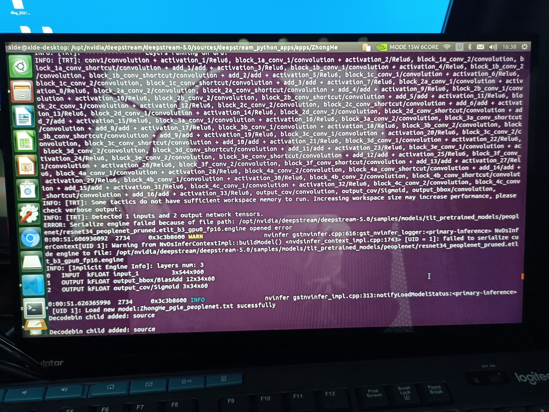

I got a problem when using deepstream to do multi-camera video analysis on Jetson Xavier NX.
The problem is the GPU usage will up to 99%, and the multi-camera debugging video will be very stuck and lagging, when I use deepstream to do multi-camera video analysis.
multi-camera means 2 or 3 RTSP cameras.
The GPU usage will be about average 40%-60% when doing single-camera (1 RTSP camera).
Official specification said Xavier NX can support 16 cameras video streams analysis, but why The GPU usage will be so high when only use 2 or 3 RTSP cameras?
Some details of my program are listed below:
  1. The nvinfer part include pgie and tracker. The pgie is peoplenet34 of TLT pretrained models, and the tracker is libnvds_mot_klt.
  2. Some screenshots after the program run are uploaded
many thanks!
By default we run ResNet10 to demonstrate 16-source inputs. Please run deepstream-app with this config file for a try:
/opt/nvidia/deepstream/deepstream-5.1/samples/configs/deepstream-app/source30_1080p_dec_infer-resnet_tiled_display_int8.txt
In your case, it looks like the model is too heavy and GPU is overloaded for multiple sources. We suggest adjust interval in [primary-gie]. Please refer to the document:
https://docs.nvidia.com/metropolis/deepstream/dev-guide/text/DS_ref_app_deepstream.html#primary-gie-and-secondary-gie-group

Hi DaneLLL, thanks a lot for your advices.
I’ve replaced the nvinfer model from Resnet34 (TLT-pretrained peoplenet model) to Resnet10 of my program, and the GPU usage was down to 30% - 50% by using 2 cameras, and the latency of 2 cameras were both lower than before and be acceptable.
