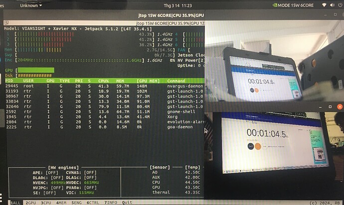

However, if I both streamed and visualized/previewed internally within the Jetson Xavier NX :
For a:
Terminal #1a :
gst-launch-1.0 v4l2src device = /dev/video1 ! nvvidconv ! nvv4l2h264enc insert-vui=true insert-sps-pps=1 idrinterval=15 maxperf-enable=true bitrate=8000000 ! video/x-h264, stream-format=byte-stream, alignment=au ! h264parse ! rtph264pay name=pay0 pt=96 ! udpsink host=127.0.0.1 port=5001 sync=false async=false -
Terminal #1b :
gst-launch-1.0 udpsrc address=127.0.0.1 port=5001 ! application/x-rtp,media=video,clock-rate=90000,encoding-name=H264,payload=96 ! rtph264depay ! nvv4l2decoder disable-dpb=true ! nv3dsink sync=false async=false window-width=960 window-height=540
For b :
Terminal #2a :
gst-launch-1.0 nvarguscamerasrc sensor-mode=0 ! 'video/x-raw(memory:NVMM), width=(int)3840, height=(int)2160, format=(string)NV12, framerate=(fraction)30/1' ! nvv4l2h264enc insert-sps-pps=1 idrinterval=15 ! h264parse ! rtph264pay name=pay0 pt=96 ! queue ! udpsink host=127.0.0.1 port=5002 -
Terminal #2b:
gst-launch-1.0 udpsrc address=127.0.0.1 port=5002 ! application/x-rtp,media=video,clock-rate=90000,encoding-name=H264,payload=96 ! rtph264depay ! nvv4l2decoder disable-dpb=true ! nv3dsink sync=false async=false window-width=960 window-height=540
I observed that there was GPU consumption :
Could you tell if the GPU consumption comes from the on-board H264 decoding or/and the on-board previewing /visualization, please ?
