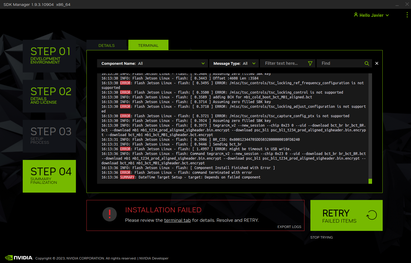

My new Jetson Orin Nano 8Gb DevKit fails to flash using the SDKManager. The following error appears in the terminal tab:
Background:
  • Host: Native Ubuntu 20.04.6, Dell XPS 13
  • Jetson: Jetson Orin Nano 8GB DevKit with SSD installed (Crucial P3 500GB PCIe Gen3 3D NAND NVMe M.2 SSD)
  • lsusb shows appropriate Bus 001 Device 097: ID 0955:7523 NVIDIA Corp. APX when Jetson is in Recovery Mode.
  • Able to boot with SD Card imaged with Balena.
  • I have tried flashing from all of the USB ports on my laptop.
The complete logs from my attempts:

this issue has been around for quite a while, and we are still debugging it.
Generally, we’d suggest try a different USB/cable, use Ubuntu 18.04 instead of 20.04, or even a different host PC.
Or give this command a try:
sudo -s
echo -1 > /sys/module/usbcore/parameters/autosuspend
Confirmed that flashing from a Ubuntu (Native) 18.04 machine fixes this issue, and my Orin Board flashes successfully to NVMe.
