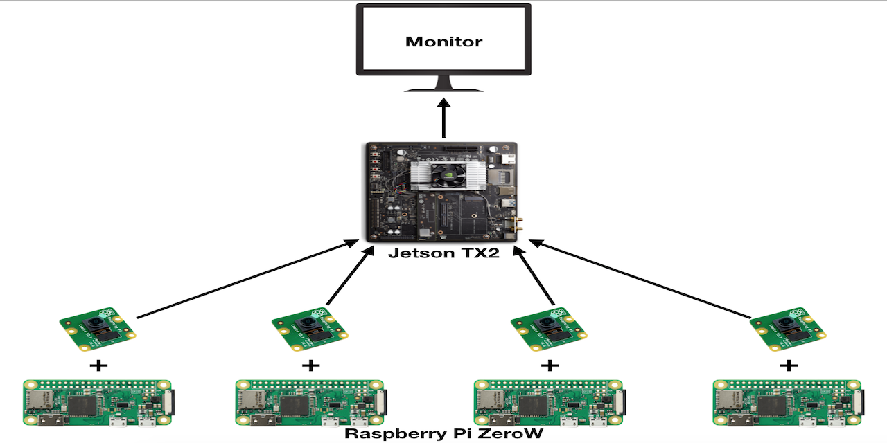

I was trying out one of the featured projects seen here…
When running the model to compile the MobileNet SSD model [compile_ssd_mobilenet.py] i get this.
