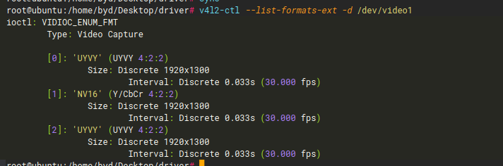

However, using the v4l2-ctl command is abnormal: there are three modes, and the resolution is 1920x1080.
/dev/video0 is the device of the same device tree file, which matches the device tree.
root@ubuntu:/sys/firmware/devicetree/base/bus@0/cam_i2cmux/i2c@1/rbpcv3_isx031_c@1a# v4l2-ctl --list-formats-ext -d /dev/video1
ioctl: VIDIOC_ENUM_FMT
Type: Video Capture
    [0]: 'UYVY' (UYVY 4:2:2)
            Size: Discrete 1920x1080
    [1]: 'NV16' (Y/CbCr 4:2:2)
    [2]: 'UYVY' (UYVY 4:2:2)

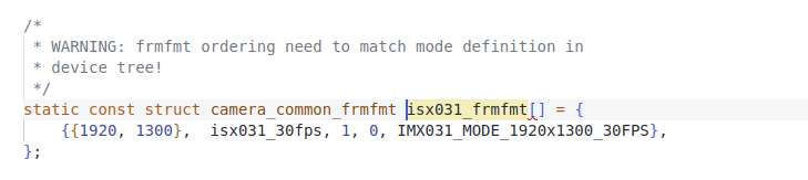

hello 1450072342,
v4l2-ctl --list-formats-ext it’s checking the supported formats from the sensor driver side.
you may examine the mode table from sensor driver.
let me taking IMX274 as an example,
./nvidia-oot/drivers/media/i2c/imx274_mode_tbls.h
static const struct camera_common_frmfmt imx274_frmfmt[] = {
        {{3840, 2160}, imx274_60_fr, 1, 0, IMX274_MODE_3840X2160},
        {{1920, 1080}, imx274_60_fr, 1, 0, IMX274_MODE_1920X1080},
        {{3856, 4448}, imx274_30_fr, 1, 1, IMX274_MODE_3840X2160_DOL_30FPS},
        {{1936, 2264}, imx274_60_fr, 1, 1, IMX274_MODE_1920X1080_DOL_60FPS},

I have modified it according to the reference, and there is only one mode. The resolution is set correctly, and I can obtain the image, but why are there still three modes?
