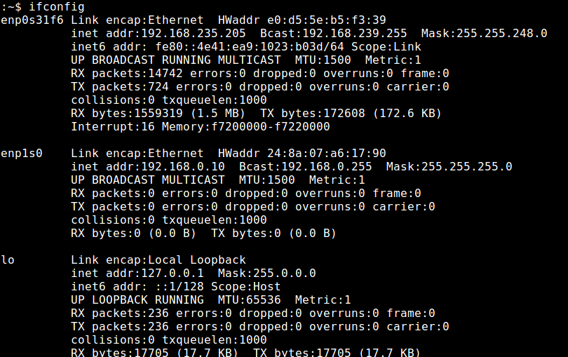

Tested using two ConnectX-4 LX 40GbE cards, then also link not established between them. Both cards installed in i7 pc’s and both running Ubuntu 16.04 with kernel version 4.15.0-50-generic. 40G/10G Cable used to connect cards is working fine as I verified using an Intel 40/10G card. Earlier this board was working fine and don’t know what happened to it now.
I have performed following tests.
mlx_issue (4)
Attaching the lshw, ifconfig, lspci, ethtool, dmesg output of board having issue. From the ouputs , card is being detected by the machine, but link is not being established. Can anyone please go through the observations and let us know is this a HW/SW issue and how can we fix this issue?.

Hi Sophie,
Thank you for your reply. I am not able to suspect the setup because I have got link established when I used another ConnectX-4 LX 40/10GbE card in the same setup. Earlier, the card with the issue was also working in the same setup but don’t know what happened to it now.
The card is detecting properly as you can see from my screenshots, but the only problem is that link not being established.
Can u please mention any registers to check the link is detected or any other debugging method to confirm whether it is an HW issue or not.
The ConnectX-4 card is installed in a Intel i7 pc having model name “Intel(R) Core™ i7-8700K CPU @ 3.70GHz”. We have tried several reboots and power cycles, but the issue didn’t resolve.
