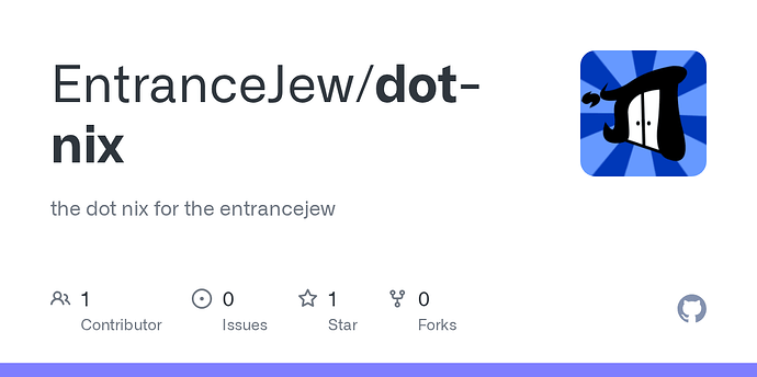

Basically, I have 2 DisplayPort cables running to 4 identical models of monitors, in 2 separate chains. In Windows it works just fine but on Linux it tries to drive 30-bit color which exceeds the bandwidth and stability of my monitors. I’ve done everything I know how to force 8bpp but the KDE developers say that “max bpc” is not supported by NVidia, but it works on Windows, so I do not fully understand.
Here are pertinent links to my configuration I have been using:
