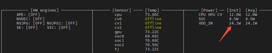

My problem is the maxmium power I can get from jtop is about 18W. And the system total power(include carrier board) is about 21.6W.
Is this right for jetson orin nano 4G?
This is a bit different from the maxmium power of 25W.
And I did the same test with jetson orin nano 8g. The maxmium power of it it’s 22W from jtop, the system total power is about 25W.
Looking forward to your reply~
I also test the orin nano 4g with jetson official development kit carrier board. The result is the same.
If you are talking about how to make the actual power consumption to meet the expectation then it means your usecase is not enough to push power. Maybe try this.
https://elinux.org/Jetson/L4T/TRT_Customized_Example
Thank you for your reply. I test the way from the link you provided before. And it works fine now.
