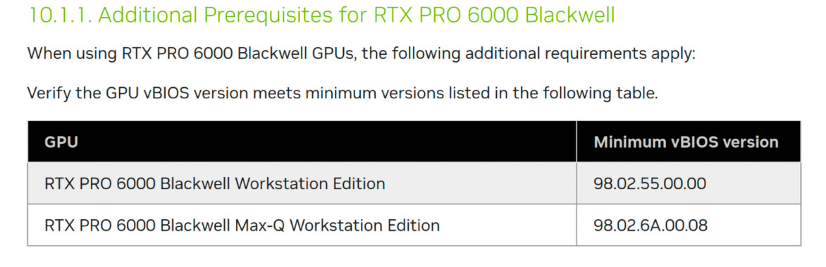

I think I found out where this mystery vBIOS is coming from…
98.02.55 but we have 98.02.52
PNY has ZERO information on when or where vbios .55 is.
Nvidia once again dropping the ball. I mean, if you set the vbios as a requirement for usage, then it had to exist at that point right? How did this even happen?

The vbios enabling MIG support will be released in 3 weeks. F’ing insane that this was sold as is. I am not a beta tester, nvidia.

The bios in my cards is 98.02.67.00.0A
