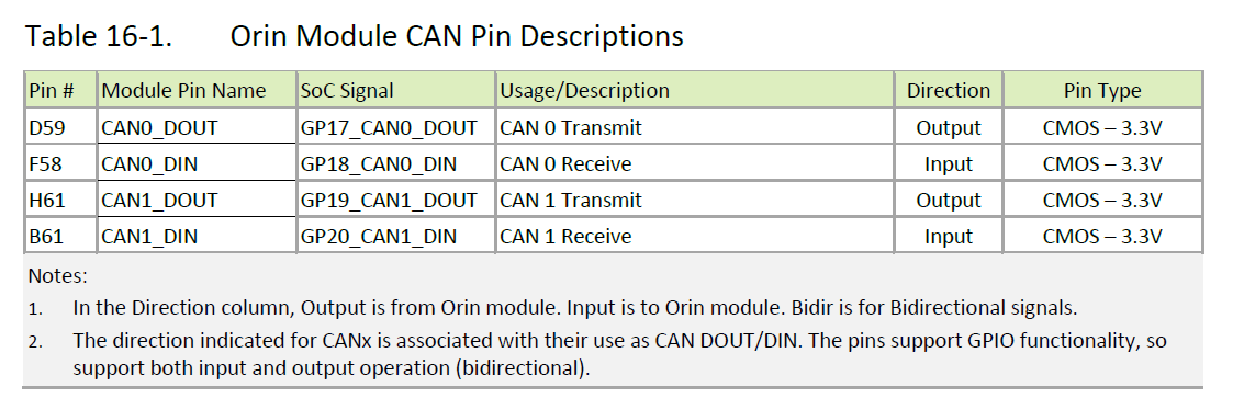

I found a discrepancy between the Jetson Orin Design Checklist and the Design Guide regarding the CAN_DOUT and CAN_DIN signal directions.
According to the Design Guide, CANx_DOUT is output from the Orin module (i.e., Transmit) and CANx_DIN is input to the Orin module (i.e., Receive), which matches the internal naming convention and direction.
However, in the Checklist , it states:
CANx_DOUT connected to input data (RX) pins of CAN device
CANx_DIN connected to output data (TX) pin of CAN device
This seems reversed.
I designed the circuit following the Design Guide’s description, as shown in the attached schematic
Here, CANx_DOUT from Orin goes to the TXD pin of the transceiver, and CANx_DIN is connected to RXD.
Can you please clarify which document is correct? Is my design aligned with the correct interpretation?
Thanks in advance!

Both documents are correct. Design Guide reflects the direction from Orin module perspective. The schematics checklist informs on how it should be connected actually. Somewhere, there needs to be swap of TX to RX for the CAN interface to work between CAN Transmitter and the CAN device (Receiver). Connecting CAN TX of Orin module to TX of CAN device will not work, isn’t it?
