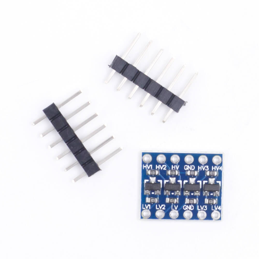

Hi JerryChang. In locals electronic shops I’m not able to find the Level Shift TXB0108.
But, I’ve found this. I’d like to know if it might works properly.
It is not validated on devkit. You can compare its characters to TXB0108
