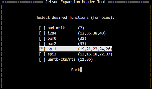

sudo /opt/nvidia/jetson-io/jetson-io.py
/boot/kernel_tegra210-p3448-0000-p3449-0000-b00-user-custom.dtb.
saved to file and rebooted

sudo cat /sys/kernel/debug/tegra_pinctrl_reg | grep -i spi
Bank: 1 Reg: 0x70003050 Val: 0x0000e044 -> spi1_mosi_pc0
Bank: 1 Reg: 0x70003054 Val: 0x0000e044 -> spi1_miso_pc1
Bank: 1 Reg: 0x70003058 Val: 0x0000e044 -> spi1_sck_pc2
Bank: 1 Reg: 0x7000305c Val: 0x0000e048 -> spi1_cs0_pc3
Bank: 1 Reg: 0x70003060 Val: 0x0000e048 -> spi1_cs1_pc4
