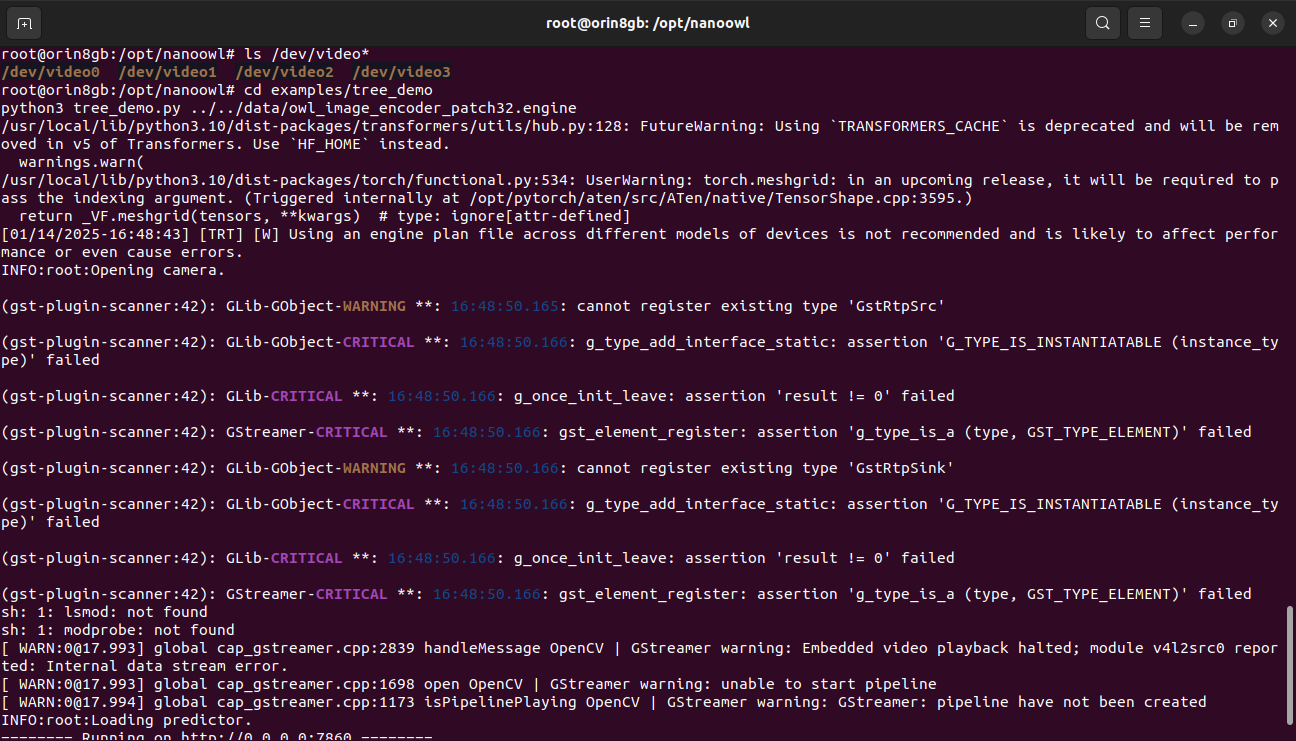

Hi, Im trying to follow the NanoOwl tutorial (NanoOWL - NVIDIA Jetson AI Lab) and getting some critical errors from Gstreamer.
First i was trying to use csi cameras (2 of them), than I saw in github repository instructions to use a USB camera. The 3 cameras are connected at the moment of the print bellow:
The server loads on http://0.0.0.0:7860/ but there is no feed from any cameras.

Looking at the code of tree_demo.py, it seems it is designed to take camera device ID like this.
With your already connected CSI camera, it is a little difficult to determine which is your USB web camera, but let’s say /dev/video2 is the one.
If that is the case, you can test with;
python3 tree_demo.py --camera 2 ../../data/owl_image_encoder_patch32.engine
Please let us know if this solves your issue.
Hi Cyato, thank you. It works with the usb camera.
Nanoowl github page is clear about using a USB camera, but can you point some direction/modification so it can work with csi cameras? When I try to run with other ids to use csi cameras, the difference in inicialization is the warnings above:
INFO:root:Opening camera.
[ WARN:0@16.220] global cap_gstreamer.cpp:2839 handleMessage OpenCV | GStreamer warning: Embedded video playback halted; module v4l2src0 reported: Internal data stream error.
[ WARN:0@16.221] global cap_gstreamer.cpp:1698 open OpenCV | GStreamer warning: unable to start pipeline
[ WARN:0@16.221] global cap_gstreamer.cpp:1173 isPipelinePlaying OpenCV | GStreamer warning: GStreamer: pipeline have not been created
