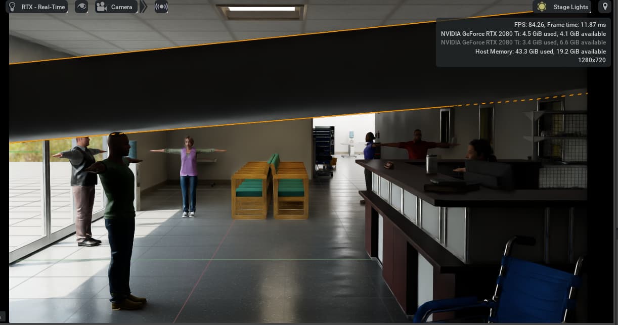

I tried with the 2023 version of isaac sim. For some reason, the navmesh generates in the ceiling. Additionally, as long as the interface is open, the primlist keeps refreshing, which tanks the frame rate to single digits. I’m not running the scene in docker, by the way.
Screenshot from 2024-01-25 16-37-49 3
Could you confirm that you are using the following navmesh settings -
  • Agent Height - 1.8
  • Agent Radius - 0.5
  • Voxel Ceiling - 4.0
Will report the navmesh prim list refreshing issue to the respective team.
These navmesh settings work. Thanks!
