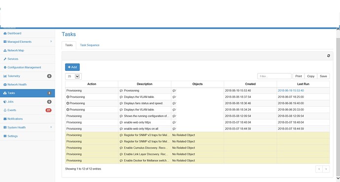

Auto discovery is off. Error you can see on picture.

Hi, Samer!
I use Mellanox switches - MSN2700B, MSN2410.
Switches are located in other network then Neo system, so multicast don’t work. I think so.
Switches added to Neo manually, communication status is OK. In Setting → Device Access I configured HTTP, SSH, SNMP.
All this are accessibly from Neo.
I turned off Agent Discovery and LLDP Discovery in Settings because I got errors like ‘Device Management Discovery’.
Ok. As I told I added switches manually. But I still see errors in page Events.
How can I eliminate this errors?
What is the exact error that you see in the events logs ?
can you send the output ?
Does auto discovery is off ?

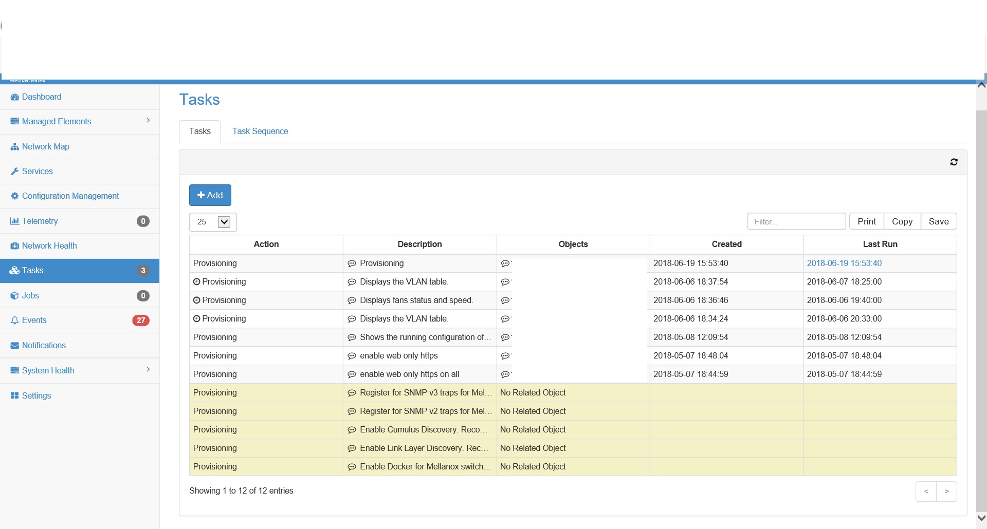

Can you send a picture of the tasks/jobs windows ?
