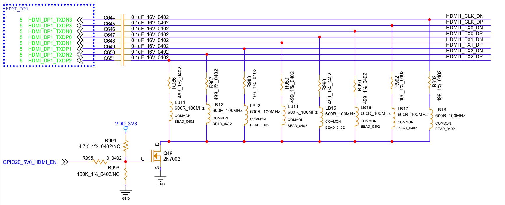

We made a customized carrier board AGX Xavier Industrial and use sor1 as hdmi output.

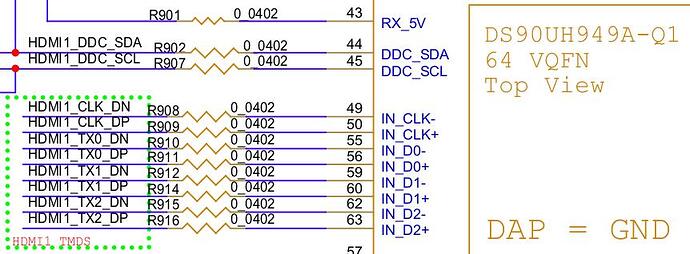

It connected with a FPDLINK III chip ds90ub949.
I found that there is no signal output from HDMI_DP1_TXDN/P3.
The connect path is head2->sor1.
Below are the changes we made in devicetree.

Below are the schematic.
Is there any setting I need to set to fix this issue!?
