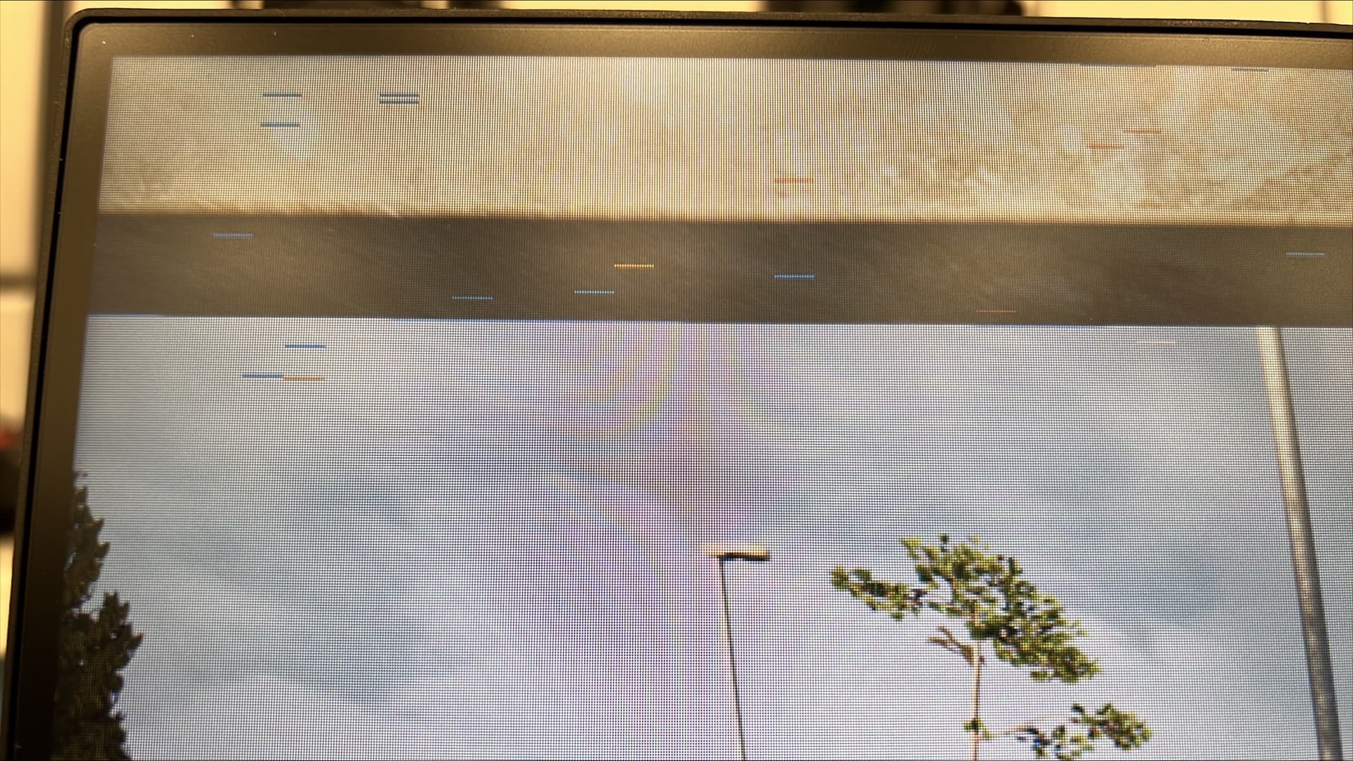

We are noticing these extra pixel (in blue and yellow) lines on our received visualization of camera feed on the OrinDevkit. What could this be related to? Even a hard restart did not help.
The Sensor is Sony IMX728. The camera model is SG8-IMX728C-GMSL2-H120Y
sudo systemctl stop gdm
sudo ./nvsipl_camera -c "IMX728_RGGB_CPHY_x4" --link-enable-masks "0x0001 0x0000 0x0000 0x0000" --enableRawOutput --disableISP0Output --disableISP1Output --disableISP2Output -d 1
