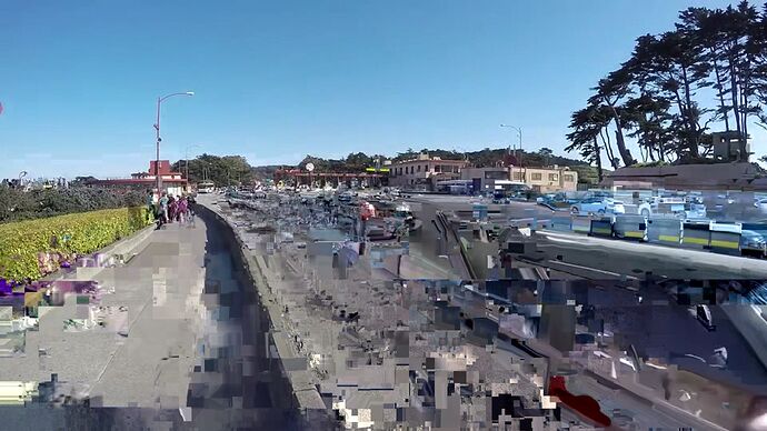

I added a buffer probe to pgie’s src pad and enable NvDsObjEncUsrArgs. In this function I set the following metadata:
NvDsObjEncUsrArgs userData = {0};
/* To be set by user */
userData.saveImg = true;
userData.attachUsrMeta = true;
Immediately after metadata creation I make sure process is encoded and call the enc_finish function.
                nvds_obj_enc_process(objEncContext, &userData, ipSurf, objMeta, frameMeta);
                // Seems to be an offset error when nvds_obj_enc_finish is called outside the for loop
                nvds_obj_enc_finish(objEncContext);
Then I keep the deepstream pipeline running and eventually I see the files getting written locally. (Default filename indicating frame # is correct as documented in NVIDIA DeepStream SDK API Reference: _NvDsObjEncUsrArgs Struct Reference) The contents of the few pictures look ok, but over time the images written gets blurry.

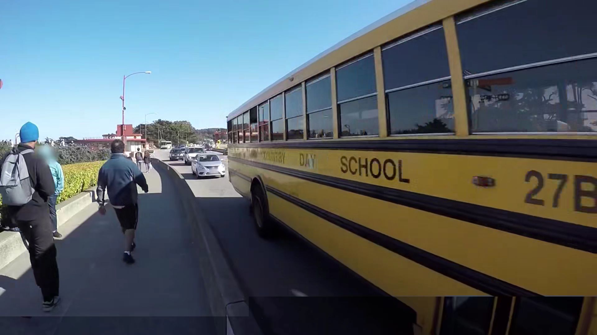

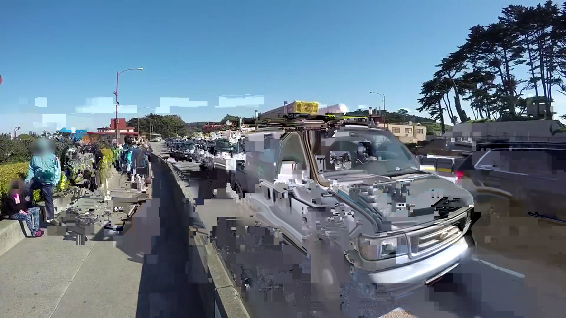

Hi @syther666 , I use your code and deepstream 6.1 docker with the sample_1080p_h265.mp4, it have no blurry picture. I get the same picture that you attached, it isn’t blurry either. So could you try run more times to confirm few questions?
1.What’s the proportion of the blurry pictures? (20%, 30%…)
2. Are the blurry pictures the same all the time?
3.What’s the specific brand and driver version of your GPU?
Hi @yuweiw ,
  1. Sometimes it starts earlier sometimes later; the example I gave begins on frame 7 and other times it starts maybe at picture 30. Frame 7 showing the first mismatch
  2. Green squares and regularly colored squares appear seemingly randomly

In the c file I already have quality=80. Looking from frame 7, the bug found in deepstream_image_meta_test.c is originating from some sort of alignment offset inconsistencies or decoding errors instead of the actual image_quality parameter.
Observing that A3000 is Ampere architecture. What architecture/GPU are you working with? Or for other Nvidia GPU environments you have access to?
Tested on a server T4 it seems to be ok; A3000 is the environment of my development computer.
