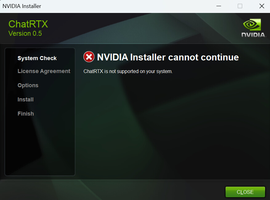

Hello everyone,
Even after consulting ChatGPT to install ChatRTX, I keep getting this error while installing:
I have an NVIDIA GeForce RTX 4060 Laptop GPU, with a Studio driver of version 576.52.
I already tried the following:
  1. Temporarily disable Norton antivirus
  2. DIable windows defender
  3. RUn installer as administrator
  4. RUn installer through command prompt
  5. Deleting installer log files and that sort of thing
Is there anyone who could help me troubleshoot this problem?
Regards, Alex
Sidenote: I use the default installation location, and I have 900 GB of local storage available

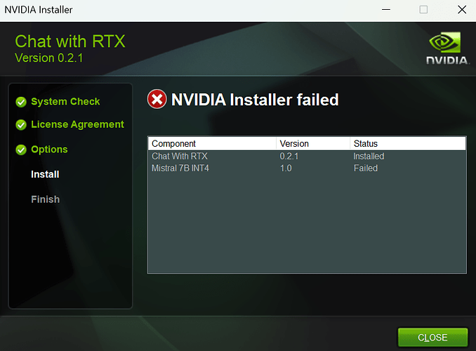

Hi everyone,
Following my earlier failed installation experience, I made a bit of progress of successfully installing Chat With RTX but with failed installation of Mistral 7B INT4’ see screenshot below.
I would greatly any assistance from anyone in resolving this.
Many thanks.
Godwin
hi @agugodwin ,
can you please uninstall ChatRTX and try installation with below steps and share logs with us ?
Generating Installation Failure Logs
By default, installer logs are automatically created in the %temp%/NvidiaLogging directory. However, these logs are temporary and are deleted when the installer process exits.
To create persistent logs that can be used for troubleshooting, you can use command line options with the installer executable.
To do this:
Run the installer executable with the following command line options:
<installer_exe_filename> -log:<log_directory> -loglevel:6
For example: setup.exe -log:c-programming:\logs -loglevel:6
This will generate detailed logs in the specified directory.
Important: To help us investigate installation failures, please share the entire logging directory with us. This will enable us to diagnose and resolve the issue more efficiently.
Is NVIDIA’s Chat with RTX compatible with the laptop version of the RTX\ 5090?
Mobile GPUs not supported. The following desktop GPUs work (per GitHub):
ChatRTX [v0.5] supports following AI models:
Model Supported GPUs
LlaMa 3.1 8B NIM RTX 6000 Ada, RTX GPUs 4080, 4090, 5080, 5090
RIVA Parakeet 0.6B NIM (for supporting voice input) RTX 6000 Ada, RTX GPUs 4080, 4090, 5080, 5090
CLIP (for images) RTX 6000 Ada, RTX 3xxx, RTX 4xxx, RTX 5080, RTX 5090
Whisper Medium (for supporting voice input) RTX 6000 Ada, RTX 3xxx and RTX 4xxx series GPUs that have at least 8GB of GPU memory
Mistral 7B RTX 6000 Ada, RTX 3xxx and RTX 4xxx series GPUs that have at least 8GB of GPU memory
ChatGLM3 6B RTX 6000 Ada, RTX 3xxx and RTX 4xxx series GPUs that have at least 8GB of GPU memory
LLaMa 2 13B RTX 6000 Ada, RTX 3xxx and RTX 4xxx series GPUs that have at least 16GB of GPU memory
Gemma 7B RTX 6000 Ada, RTX 3xxx and RTX 4xxx series GPUs that have at least 16GB of GPU memory
If you’re trying v0.5 with a desktop GPU and RTX 3xxx, you might want to try v0.4 or older. The installer is about 11GB. Didn’t find a live download link that hosts them but it might be floating around somewhere. Look for:
