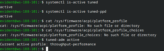

These files don’t exist on my fedora or cachyos (both KDE)

throughput-performance is tuned profile name. If you look into it’s config in acpi section, you’ll see that tuned tries to apply platform power profile called ‘performance’ assuming it’s available. Maybe driver for your laptop exposes power profiles differently for user. Try checking bios settings, default power profile settings may be there.
