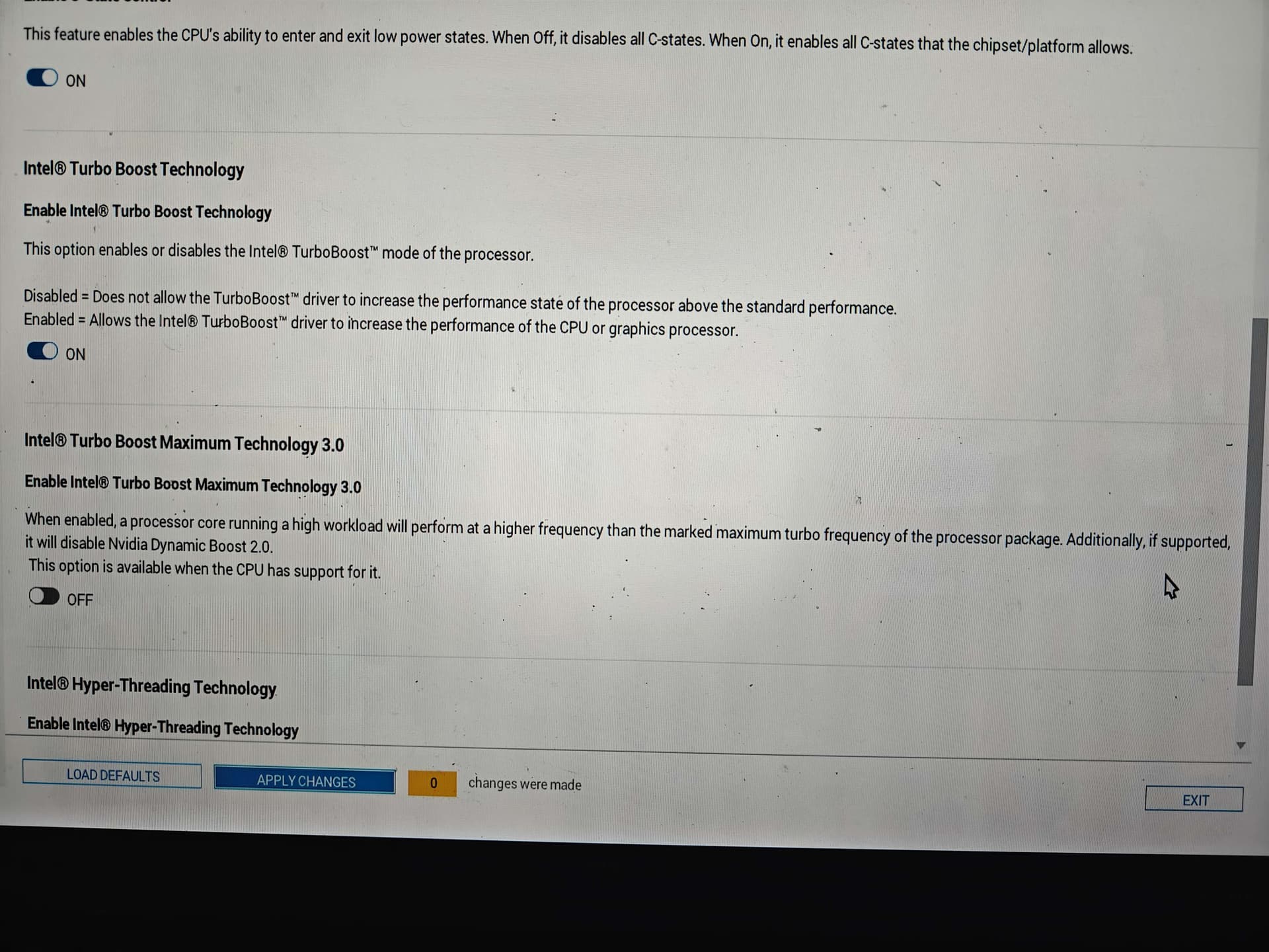

Here it shows my gpu support Dynamic Boost but in powerd it show the error

Here is the only option in my bios showing that if I enabled 3.0 it will disable Nvidia Dynamic Boost.
