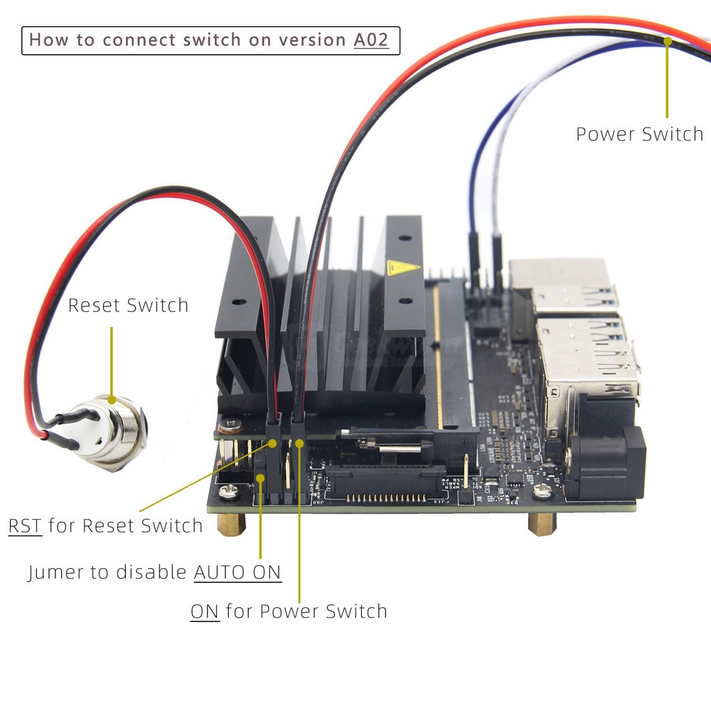

This metal case is compatible with both A02 and B01 versions now. We have to increase the distance between the JETSON NANO motherboard and the front panel of the case to install the switch.
We cancel the TF card slot!!
We found that we couldn’t insert the TF card by hand or plastic tweezers even if we kept the TF card slot, so we have to cancel this card slot; We hope that the official NVIDIA will adjust the position of J50 in subsequent versions.
