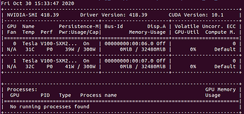

my GPU summary
Here is the GPU summary of the Driver and CUDA versions.
How can I fix the issue?

We are sorry but your system does not meet the requirement for Clara Parabricks Pipelines to run.
For two GPUs you need at least 24 CPU threads. This error is happening because you only have 8 CPU threads.
