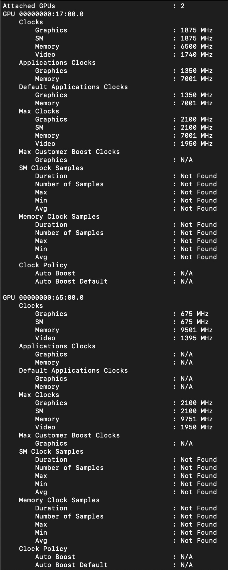

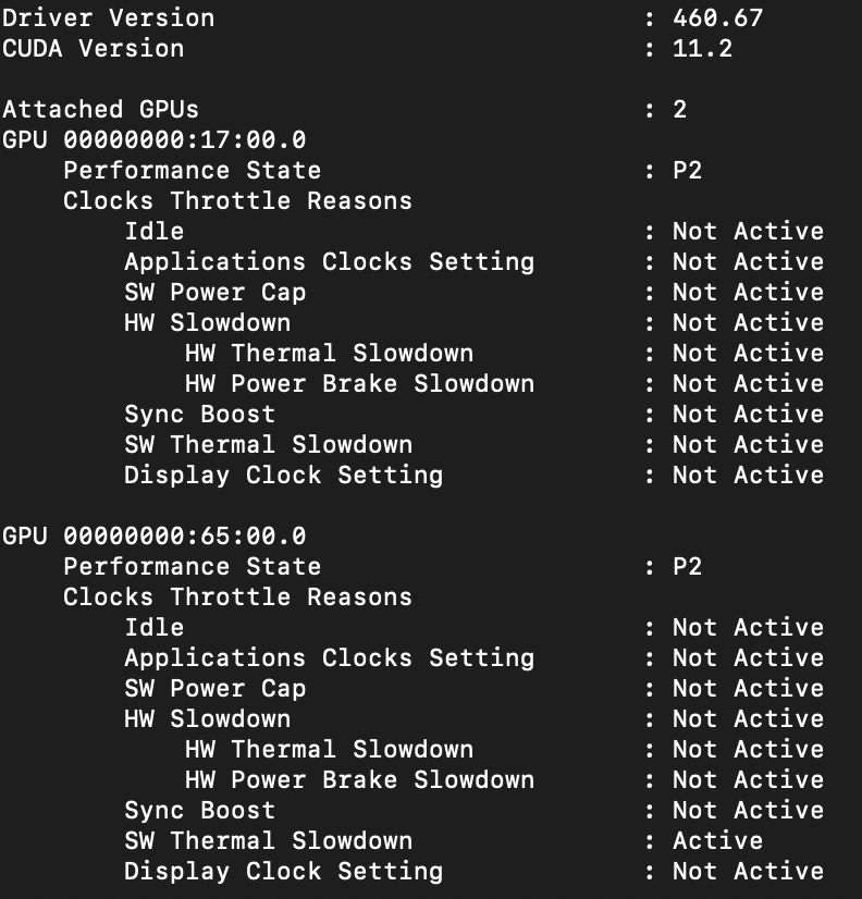

My RTX 3090 is running on the latest ubuntu drivers (installed using runfile) but immediately encounters SW Thermal Slowdown when under load. The GPU has adequate cooling and maintains an average temperature of 61 degrees celsius. The output from nvidia-smi:
The output from nvidia-smi -q -d PERFORMANCE:
The output from nvidia-smi -q -d CLOCK:
Interestingly, the Titan RTX while running at a much higher temperature does not encounter the thermal slowdown. I’ve attempted to manually set the clock speed of the graphics and vram but the RTX 3090 does not allow for that option. Please advise on possible solutions. Thank You!
I guess the memory is overheating which can’t be seen:
https://forums.developer.nvidia.com/t/request-gpu-memory-junction-temperature-via-nvidia-smi-or-nvml-api/168346/21
Would manually reducing memory clock speed or voltage be a possible solution?
Possibly. Memory voltage can’t be manipulated on Linux, AFAIK. Reducing memory clocks requires running an Xserver on the gpu with coolbits option.
Would of course reduce performance. I’d check for the add-on fan approach from the linked thread.

In case anyone else comes across this in the future, I was hitting a similar issue with my 3090 FE. I had power-limited it to 300W and boosted the GPU clock by 225MHz. When running gpu-burn to check the stability of those settings, I found that it was being SW thermal capped (down to around 280W).
My GPU core and memory temperatures seemed to be at reasonable levels (under 65°C). Being on Linux I couldn’t check the memory junction temperature (I kinda of had an idea it’d be high though).
Even the though it was being throttled cause of thermals, the fans weren’t running high, around 50% or so.
The way I managed it was by setting a more aggressive fan curve using LACT (on Fedora44 at the time of writing):
After setting this, the GPU wasn’t being thermal throttled on using gpu-burn. I’m certain the thermals on my card have gotten stale and the proper solution is to redo them, but this works as a tentative fix. ymmv.
