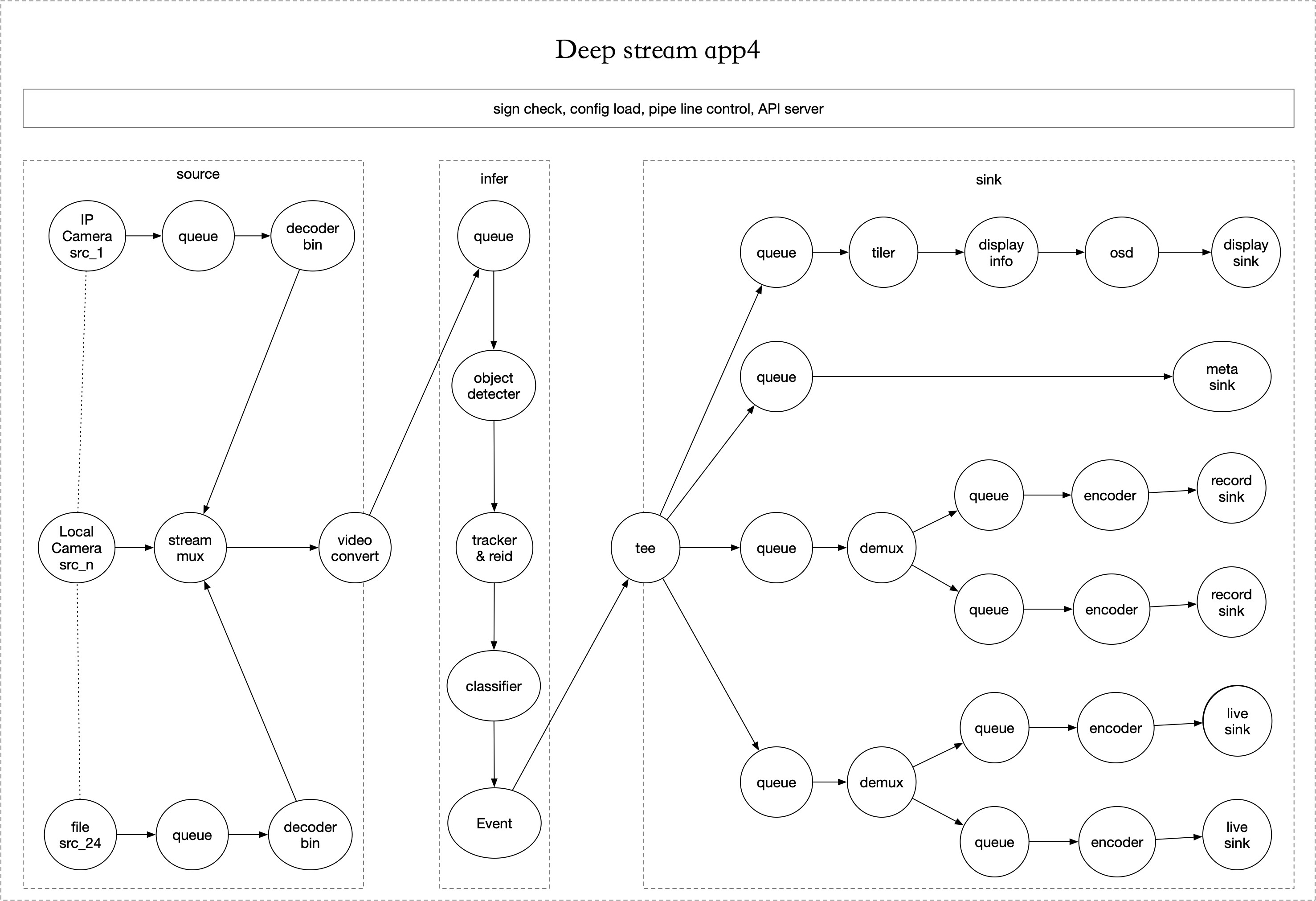

my pipeline is like above. the streammux elem is nvstreammux plugin. the demux elem is nvstreamdemux plugin.
it works ok on deepstream 6.0, jetson NX.
but when run it on deepstream 5.0, Jetson Nano. it will crash at every bootup.
If I let nvstreamdemux src_%u pad link nothing , it can run ok .
event if I let nvstreamdemux src_%u pad link to a fake fakesink, it will crash at every boot up.
