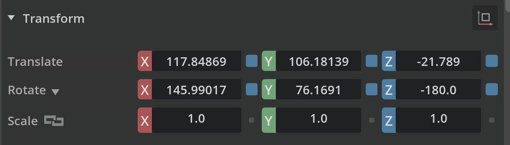

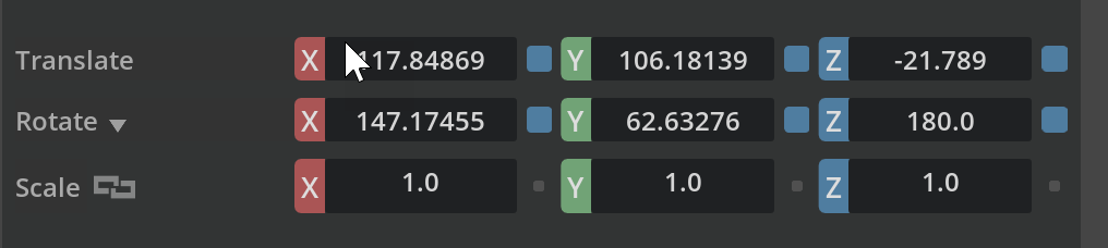

I have an action graph that rotates an object to look at the camera. I use Rotate to Orientation fed from Get Look At Rotation. As I move around the objects, they turn back towards the camera, but occasionally do a full rotation first. Watching some of the rotation values, they flip from values like180 to -180 for slight movements. It happens multiple times as I move around the target object.
Before movement:
After slight sideways movement of camera (interestingly this one has z of zero):
Another minor movement example, before:
After:
Is there any way to stop this flipping around?

Ok I asked the experts and they knew what it was straight away. We have seen this before. It is where the object gets very very close to “0 degrees” or on a “pure” axis. This is a problem with programming angles in XYZ Euler and not quaternion.
Euler Angles · UnityTipsRedux (gitbooks.io)
Beyond this I cannot help much more.
Thank you for chasing it up. Could you pass a feature request to the core team - add quaternion input support for Rotate To Orientation.
Note: Normally “orientation” is a quaternion (e.g., xformOp:orient is a quaternion, Get Look At Rotation output has Rotate XYZ vector3 and “Orientation” quatd4 – except Rotate to Orientation has an input of Target Orientation that is a vector3).
Zero angles I think will be somewhat common as looking from a flat angle will mean the Z rotation is normally zero (or ±180). E.g., walking around a target and use it to target the camera will frequently be at eye level I think.
