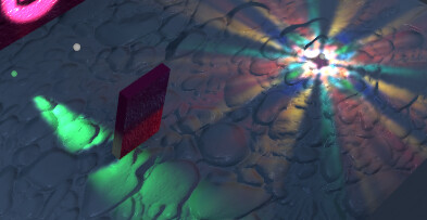

I’m now having some extremely weird bug where my lights receive wrong shadows from other lights… it’s random, seemingly dependent on shader/geometry complexity and the number of samples, though it looks the same as long as the input data doesn’t change. I triple-checked my structures, payload usage, etc, but I can’t figure it out. The code worked fine in OptiX 6. Main part of raygen looks roughly like this:

What happens is that suddenly light 2 may start using shadow from light 1 and so on - if I create another light, it shuffles differently again:
(The green spotlight is wrongly using the colored point light’s shadow)
It feels as if the optixTrace / hit programs are not synchronous (??) and I’m not getting the correct payload…

Yeah that indeed seems strange based on the code you included. You’re still on the 590 driver I assume? Are you currently testing a Debug build? We’d had some reports of compiler issues with Debug in 590, and if you can manually unroll the samples loop and it starts working, that seems to suggest a compiler bug. If that’s the issue, you could potentially try using an earlier driver, or try switching between PTX and OptiX-IR, or try a Release build, and see if any of those things affect the outcome.
I don’t immediately see any issues with the code. To me it looks like the only thing that could go wrong here and cause the symptoms you see is if the call to LightPoint() filled out a position and color from two different light sources, but I don’t suspect that’s the case, and your unrolling data point seems to rule out that possibility.
This app is a Unity plugin, right? Do debug prints work in your environment? If so, you might be interested in wiring up debug pixel coordinates and a debug output flag, so that you can print out values for a single thread based on a specific pixel you want to check. Might be worth checking the loop indices and light pos & color for each loop iter and see if they match what you expect. If this is a compiler issue, there’s a chance doing this might change the behavior.

So I was banging my head against the wall with this bug for half a day and then my friend who has some compiler development background came to bang his head against the wall with me until he suggested replacing this:
randomPos = GetRandomPos() * lightRadius + lightPos;
with this:
randomPos = GetRandomPos() * localLights[i].rangeParams.x + localLights[i].position;
…and it worked! Our combined theory is that the compiler put lightRadius/lightPos into some registers that were SOMEHOW overwritten down the optixTrace. But luckily it did reload the constants properly if we ask it to explicitly. OptiX6 didn’t have this issue, I can see that the old rtTrace call used less arguments or perhaps the payload registers were implemented differently…
Unrolling the loop also worked (but I couldn’t use it because it needs to be dynamic).
In the CUDA code lightPos/lightRadius are never overwritten anywhere else. LightPoint() only writes localColorData. Just in case I even declared other arguments as const, but it didn’t make a difference.
I’m also still using a pretty ancient CUDA 9.1 haha… just to check if the newer one is smarter, I installed VS 2022 and CUDA 12 on a different machine and tried to rebuild the project there but it looks like the CUDA API has changed a bit and it’s not gonna just compile right away, will need some more time to check it there…
The app is indeed mainly a Unity plugin, although it’s engine-agnostic and I helped a few devs/companies integrate it into their own custom engines. I’m testing it in Unity because of convenience. Somehow I never tried these GPU debug prints, mainly just debugging the same way as any shader… changing stuff and seeing changes or outputting intermediate values and looking at them.
UPDATE: recompiling the kernels using CUDA 12 fixes the bug!

Ah excellent, and very good triaging, thank you for the update. I’m glad you are unblocked. Okay so there’s a compiler issue that got fixed along the way somewhere between CUDA 9.1 and CUDA 12 when using OptiX. We are indeed no longer testing CUDA 9, but we can check and see if this is something we can fix. Your theory sounds plausible to me, it’s possible that the issue is a register stomp somewhere.
So yeah debug prints based on clicking a pixel can be really handy, I think it’s worth spending a half hour to wire it up so you have it when you need it. You also might have some success connecting the Nsight Visual Studio Edition debugger. That’s still a bit fragile, so if you have trouble, don’t bang your head on it too long. We are working on it and hope soon to be able to announce and demonstrate improved symbolic debugging in OptiX.
